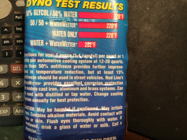

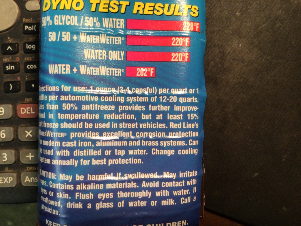

A note about water wetter. I used Water Wetter and distilled water in a Model A one summer. Just seemed like a good idea.
The block got very badly rusted. I had to clean it with rust remover.
I did not follow the directions which state use AT LEAST 15% ANTIFREEZE for street vehicles. By itself it will not protect against rust on iron.
I now just use 50/50 green antifreeze in my antique cars.
