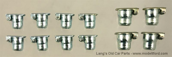

23T..Tie Rod lever oil cups. I am missing the cap off one of my oil cups. It sure looks like there is a hex at the bottom, and it would screw out. But, all the oilers I see are press in. Are they all press in type? Thanks..Tommy

I believe the oilers with the spring loaded cap are tap in. While the oilers (grease cups) with the screw on top are screw in. Jim Patrick

Post by Rich Eagle » Sat May 22, 2021 4:26 pm

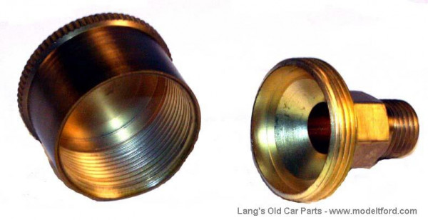

Yes, the flip top cups press in. The screw on cups have a threaded base as well as the brass, knurled twist type shown here.

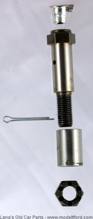

Thanks.It looks like the hex I am seeing is actually the bolt head, and the oiler presses into the bolt head. Is this correct? Thanks

Post by DanTreace » Sun May 23, 2021 9:12 am
Tommy
The 17-27 tie rod bolts and oilers look like this:

Post by tommyleea » Sun May 23, 2021 9:22 am
Tommy
That's it right there..Thanks..Now I know..
