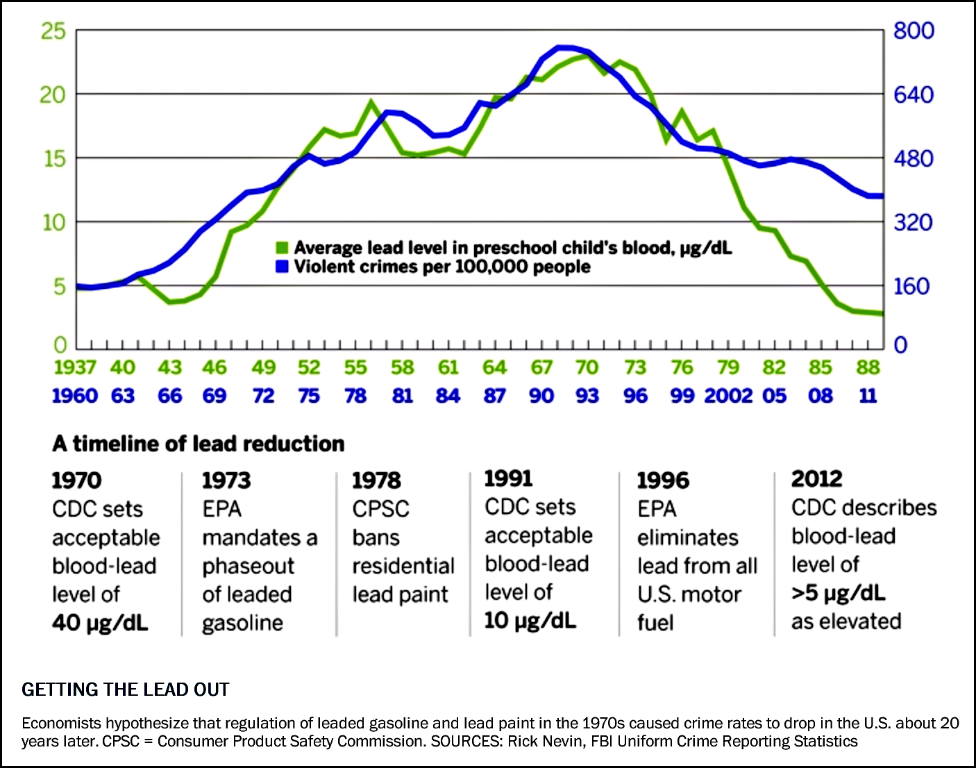

- Posts: 6581
Re: Model t and ethanol
Octane rating in the 1920's was between 30 & 60 so why put anything higher in a T
This chart should spur conversation
- Posts: 8639
White lead... Oh! That FIEND.... that Little Dutch Boy!!
- Posts: 7411
The reason that lead was removed from gasoline is that lead is death on catalytic converters...
...and it makes us stupider than we already are.
