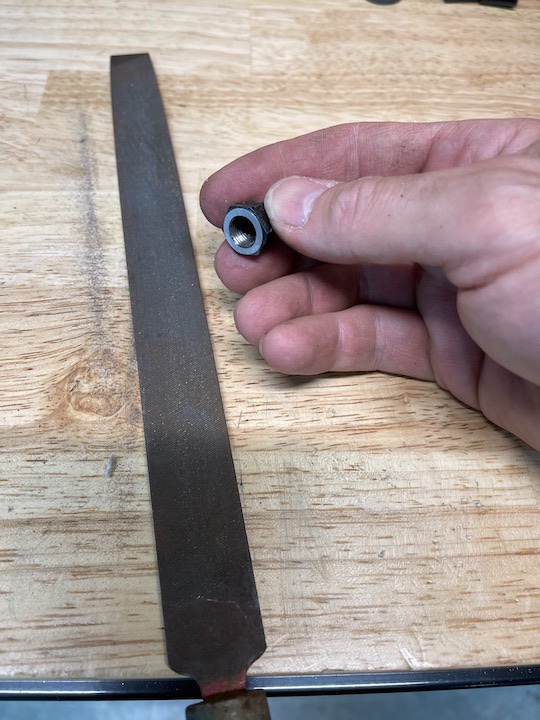

Well that worked. I never thought of filing the back side of the nut. It took a few tries but it lined up the hole.
