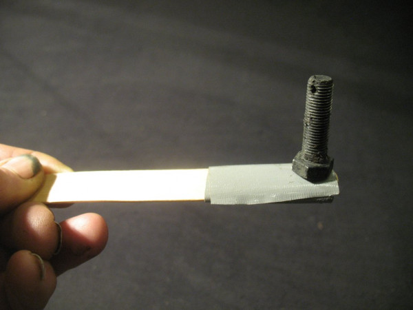

Tongue depressor, Gorilla tape.

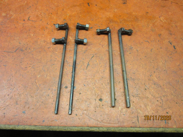

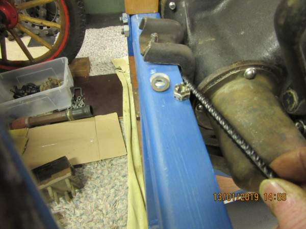

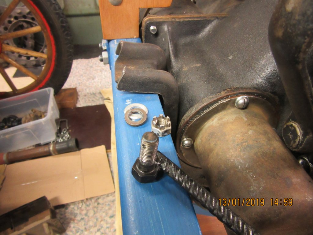

Re: How do I get this bolt into that hard-to-reach place?
I use this .
