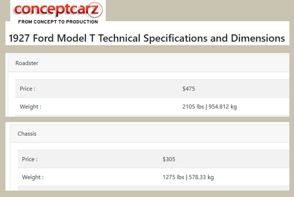

In case someone doesn't have an exact weight to answer your question, I clipped these from:
https://www.conceptcarz.com/s1963/Ford-Model-T.aspx If my math is right everything but the chassis weighs 830 lbs. Minus fenders, running boards, splash aprons etc and top would give you the weight.
I hope you can get closer than that but if you can't this may help.

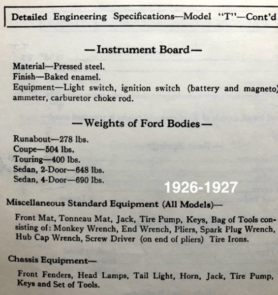

Here you go, Ford Sales Data book, Sales Equip. Co.

That weight includes the trunk. As you described, 2 guys can move it around. To walk it off a chassis, 3 guys. One @ each door & 1 in back.

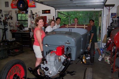

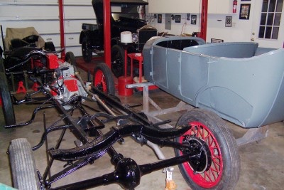

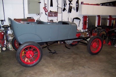

BTW, you'll need 4 to do the lift / body drop safely. That is four for the Improved runabout body.
But, for the Improved touring body, best to have six for the lift and drop.

Thank you guys! Appreciate the information. (And I loved the picture of y'all picking up the touring body!!)
