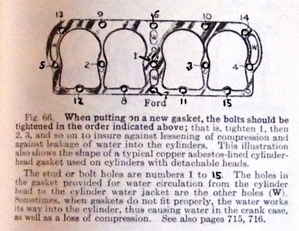

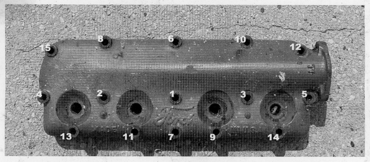

The proper sequence is needed for the Ford cylinder head bolt tightening. The center bolts must be tightened down first. This is because the head gasket is so narrow between cylinders 1-2 and 3-4. And for best results of a long living gasket, the cylinder head and block surface should be flat, preferably surfaced to be totally level.
fg84 (600x464) (2).jpg (153.49 KiB) Viewed 4106 times

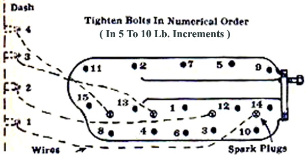

Well! I've seen at least 4 "proper" sequence diagrams. Most important is to start in the center and work out, tightening a few foot lbs at a time until you reach 50. Then warm up the engine without driving it. re-torque to 50 while hot if the iron head, but if aluminum, wait for it to cool down before you re-torque it. Then start it up and drive a short distance maybe a mile or two just enough to get it to normal operating temperature. Repeat the torque process either hot for iron head or cold for aluminum head. Do this at least one more time until it remains at 50 after you have driven it.
It seems there are almost as many different diagrams as there are timers or spark plugs. Most of them follow the Service Manual recommendation Dan posted.
This is the one that comes with the instructions for the MT-100 gasket.
