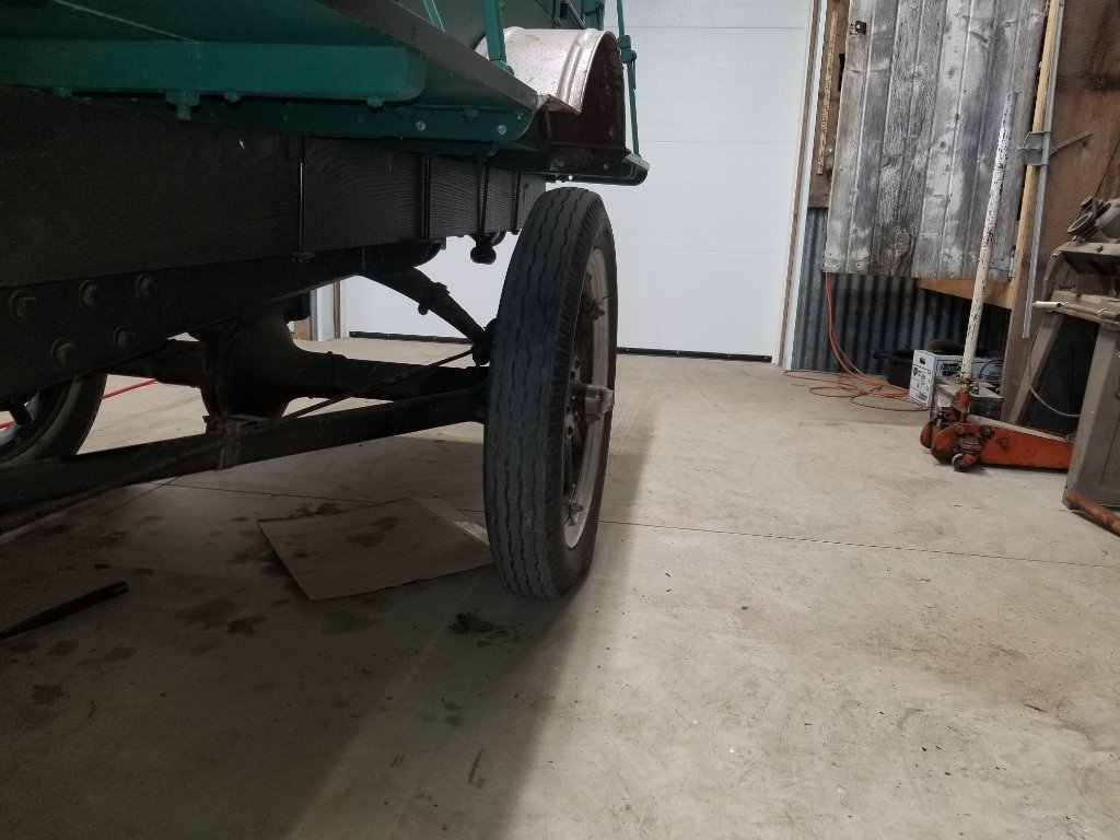

I topped off the tires on the TT a week ago( about 5 lb each. 1st time I have had to add air since I put it back on the road a couple years ago. Today I go in the shop and find the right front and left rear flat. I drove it to town last weekend. The only drive this year. I aired them up this morning and they were both flat in ten minutes! I will take them apart and see what the problem is. The front tubes are only 2 years old, I hope its not a tube failure.

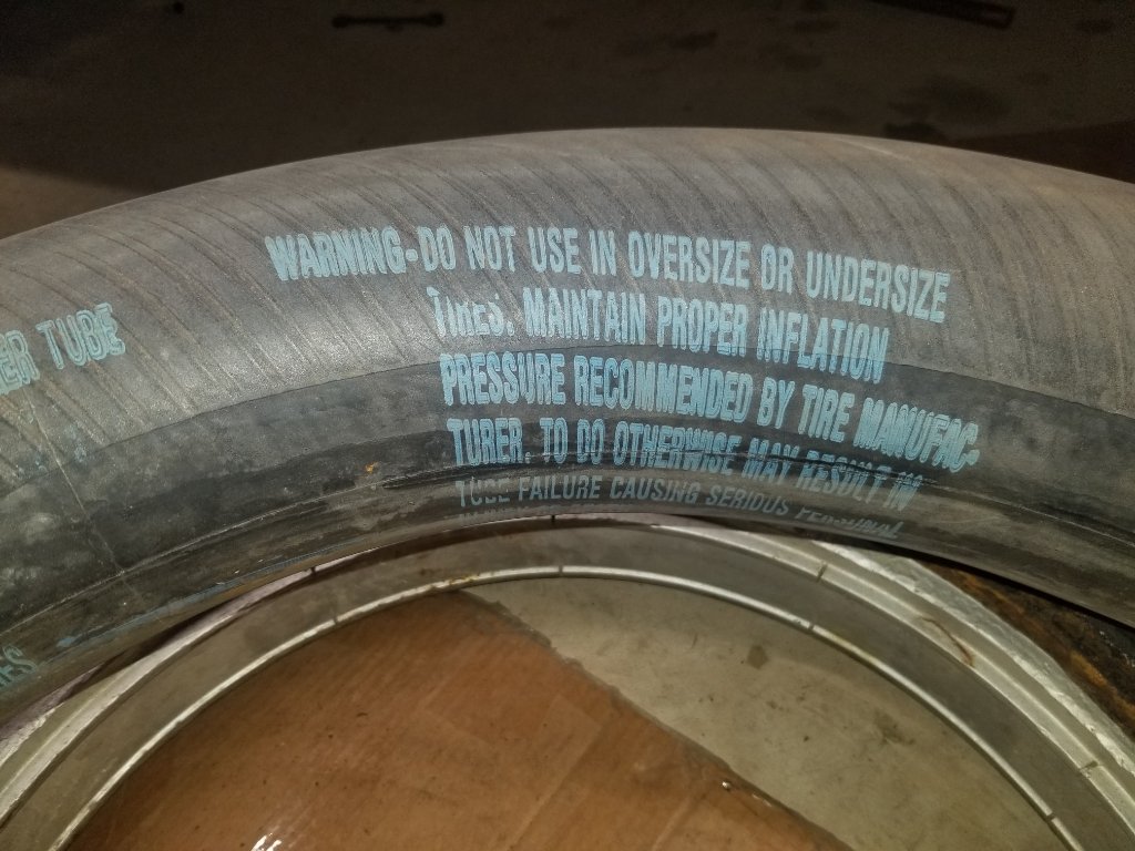

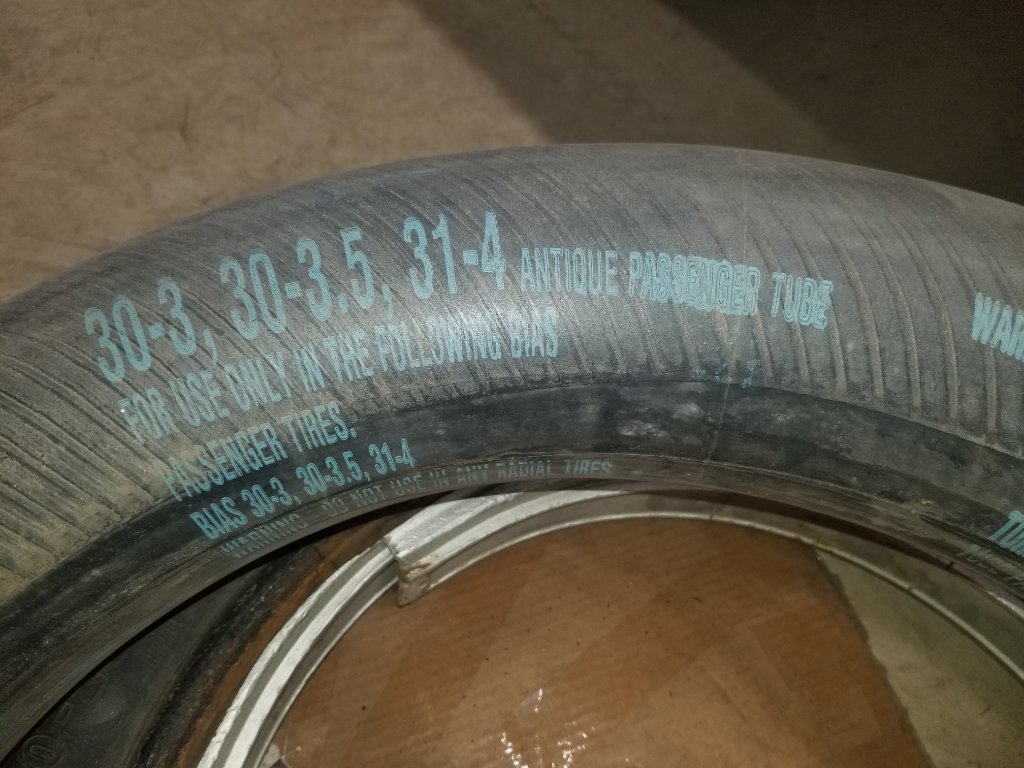

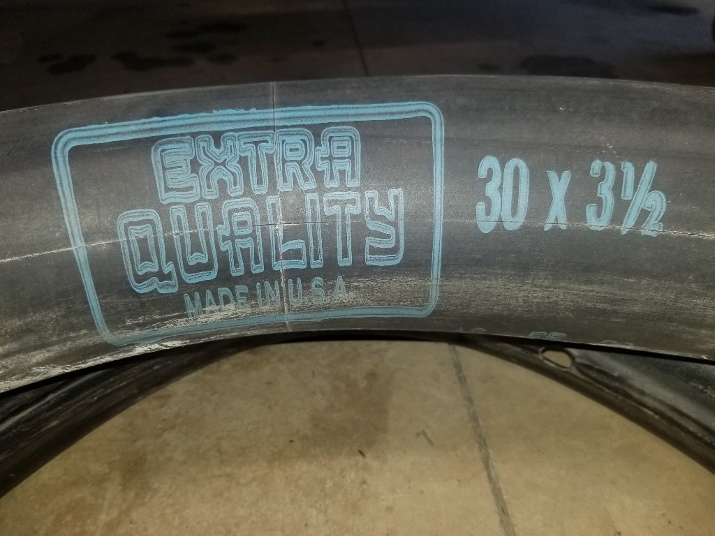

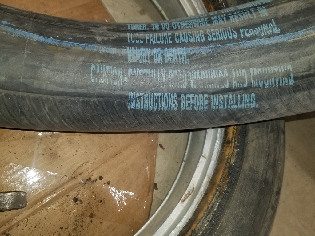

Ok, I couldnt take it. I had to see whats up with the flats. I pulled the 30x3.5 Kelsey from the front. Took out the tube and aired it up. Nothing found. Not leaking. Smack the forehead moment. I didnt check the valve core for a leak. Since it went flat in ten minutes after inflation, I was sure something major was wrong. I checked the valve core with the spit test after I inflatex the tube. Nothing. I also realized the tubes came with the truck, I had installed new Riversides on the front.
This is the only printing on front tubes

Steve, I suspect you suspect the tubes may have let go at the seam. That's the kind of junk we have had foisted upon us from the suppliers for years. I do not put Hartford tubes in this bracket. Most seem to have had few problems with these. There are now quality replacements available.
- Posts: 7035
Re: Flat feeling TT
Darn Dallas, your photo of the tube came up after I had read Steve's post while I was responding. That's not one of the made in Faroffganistan he had the trouble with. From your response it could be that the valve core did not seat after you inflated it. Interesting that the tube prominently displays the country of origin, but does not show that same confidence in identifying the manufacturer.

Dallas, those tubes have been in there since the mid 90's or so, don't recall where I got them for sure. Probably from Langs, that's where I got the rear tires. Dave
1925 mostly original coupe.
- Posts: 7035
Re: Flat feeling TT
So we are looking at tubes 25+ years old. They must pre-date the rubbish that has been pushed in latter years. They would be well worth persevering with. I have one in use in one of my cars, perhaps in my imported LHD Tudor. They even feel different to the current crop.

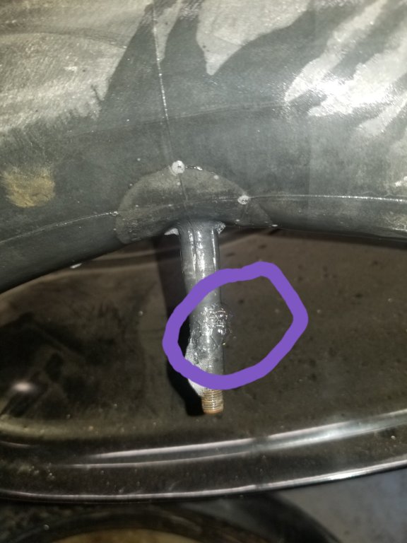

Finally got back to the TT. Both front and rear were leaking through the rubber about 1/2 way up the valve stem. One had a visable split when aired up. The other had no visible signs but made soap bubbles. Lucky I have extras. Now I guess I will learn how to replace a valve stem.
