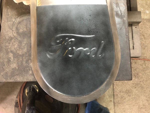

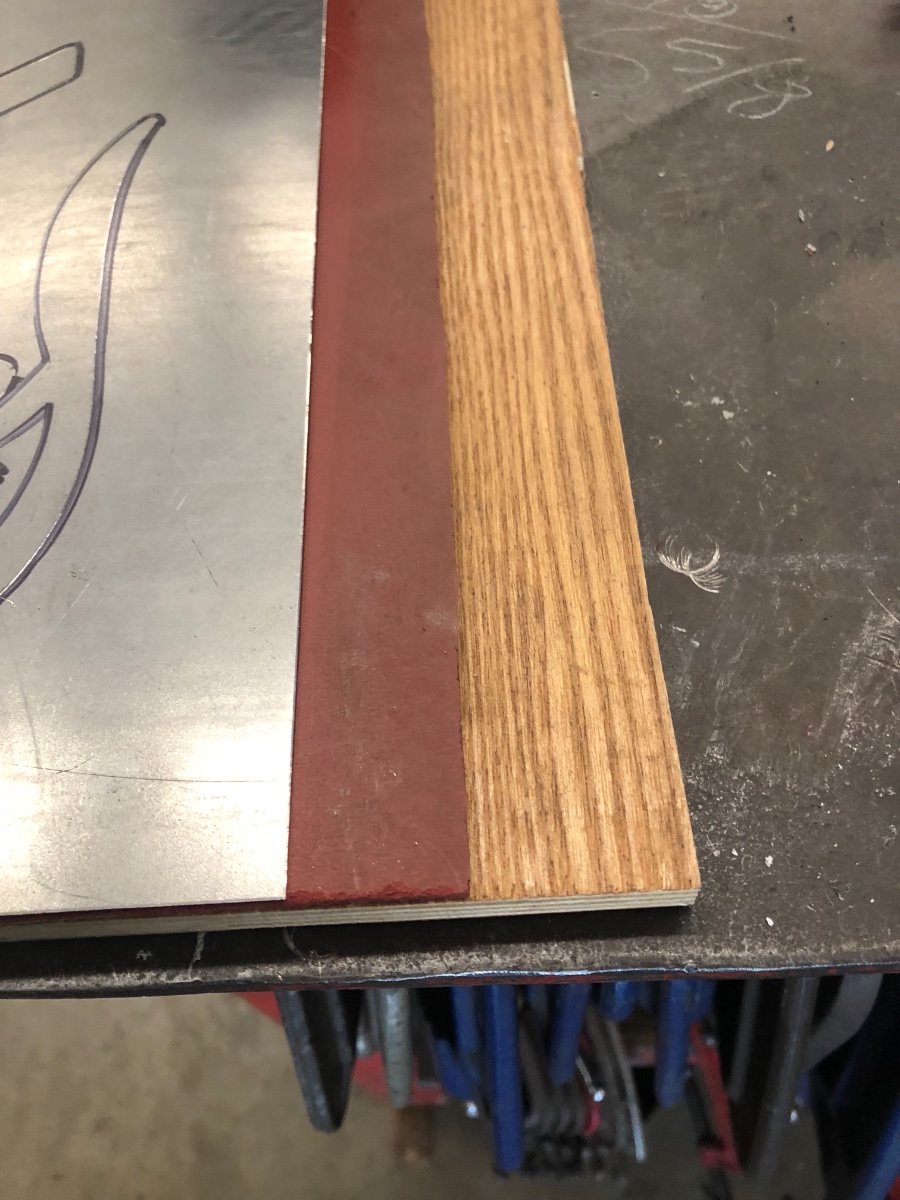

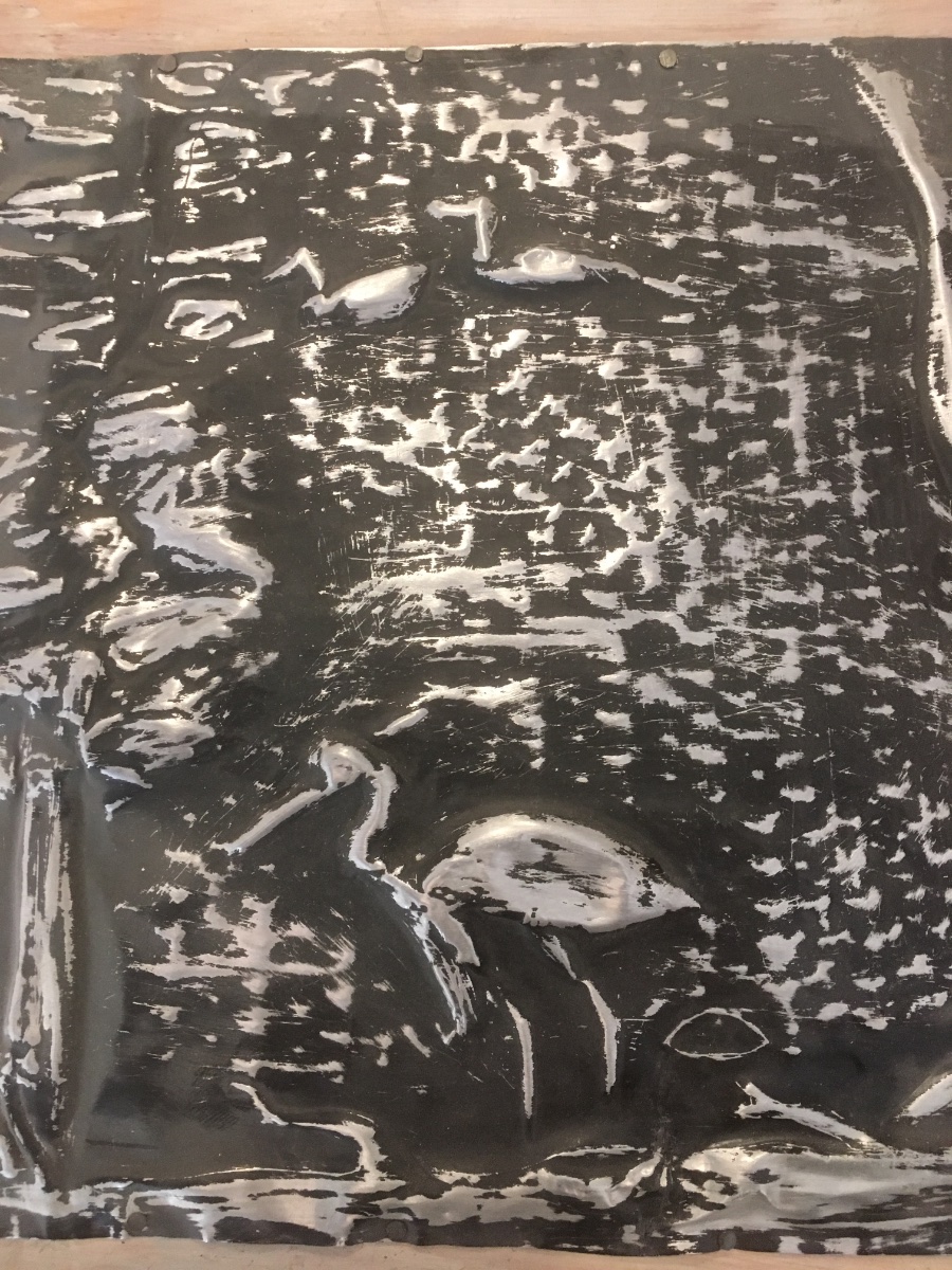

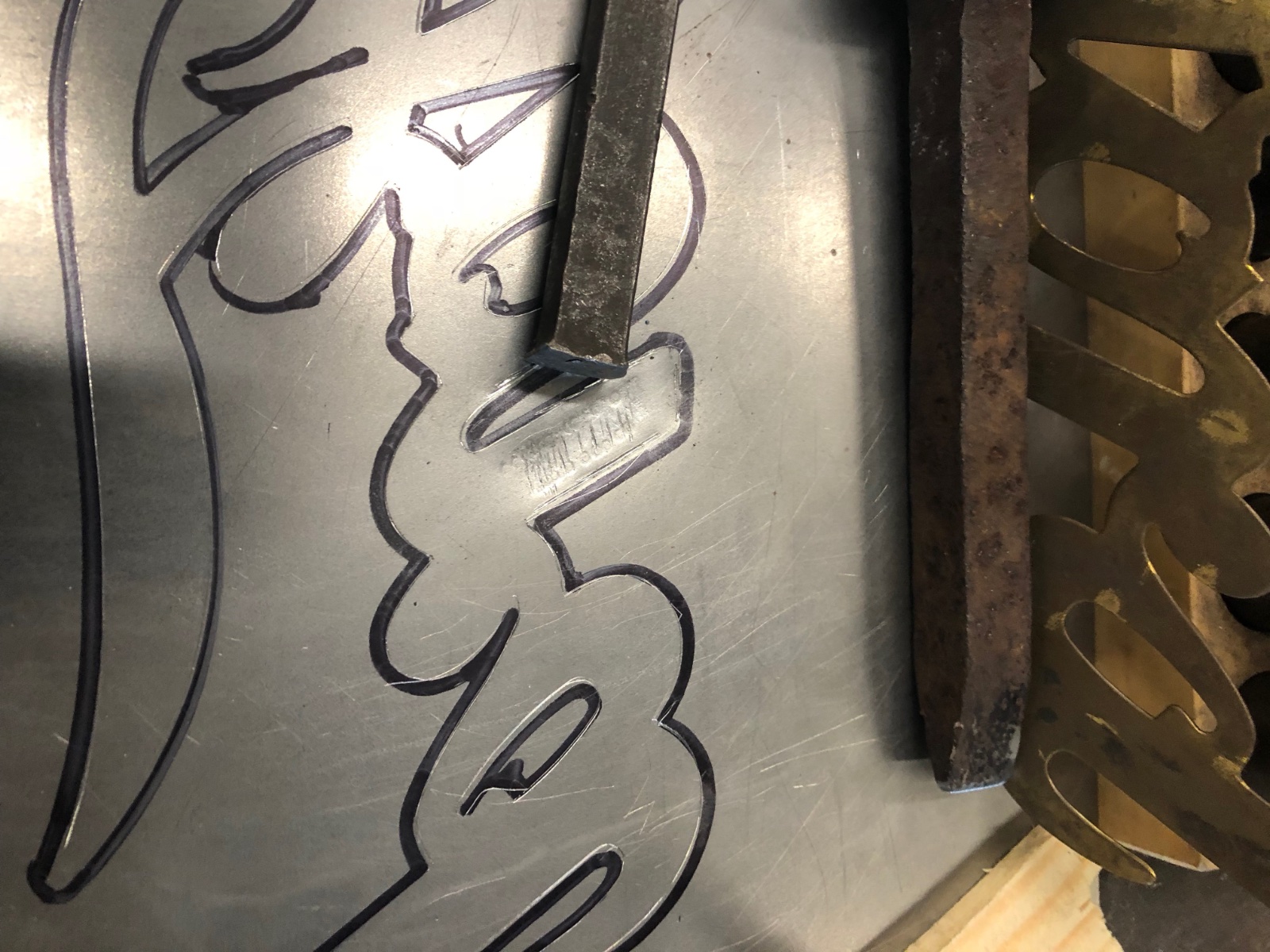

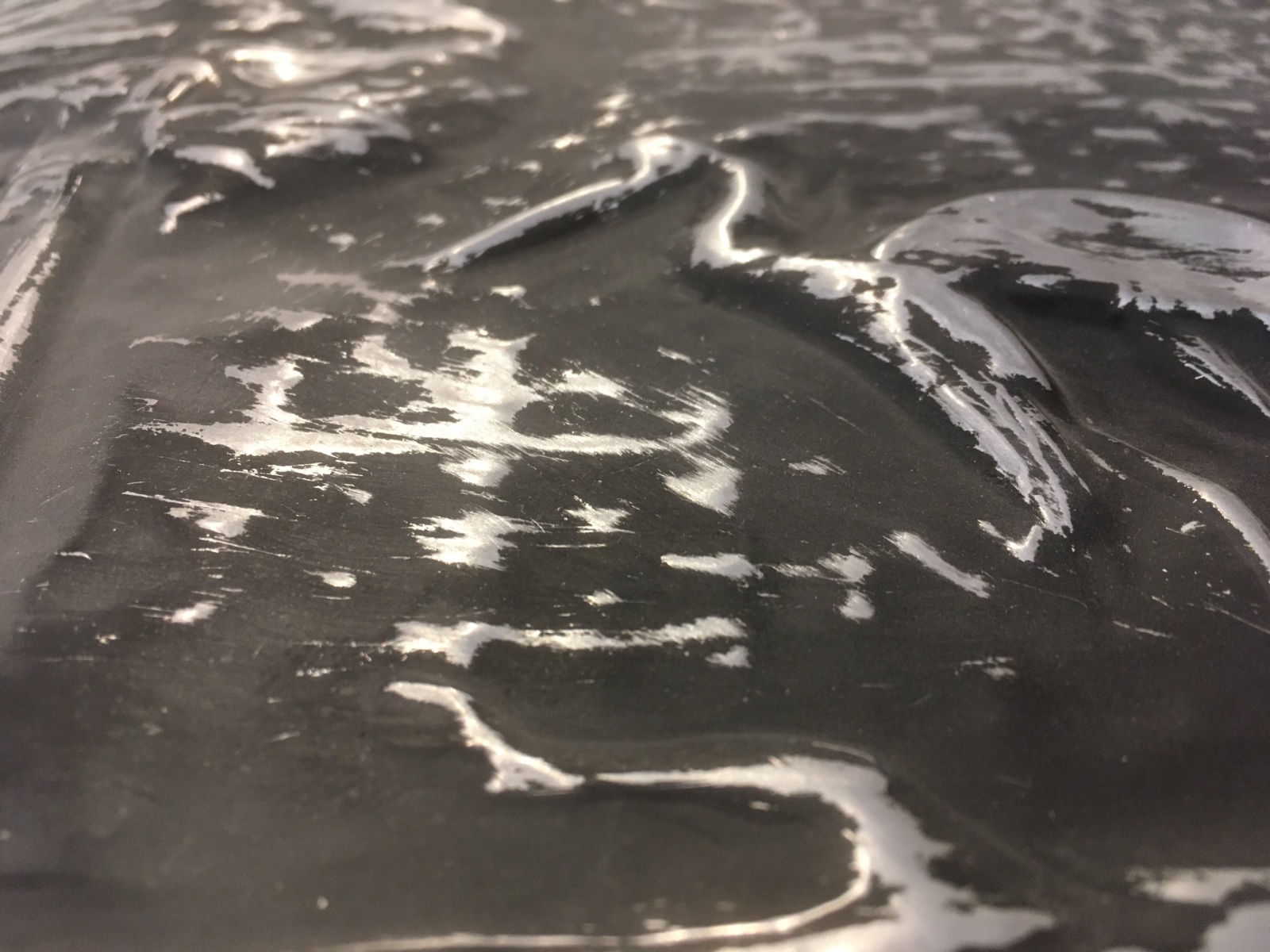

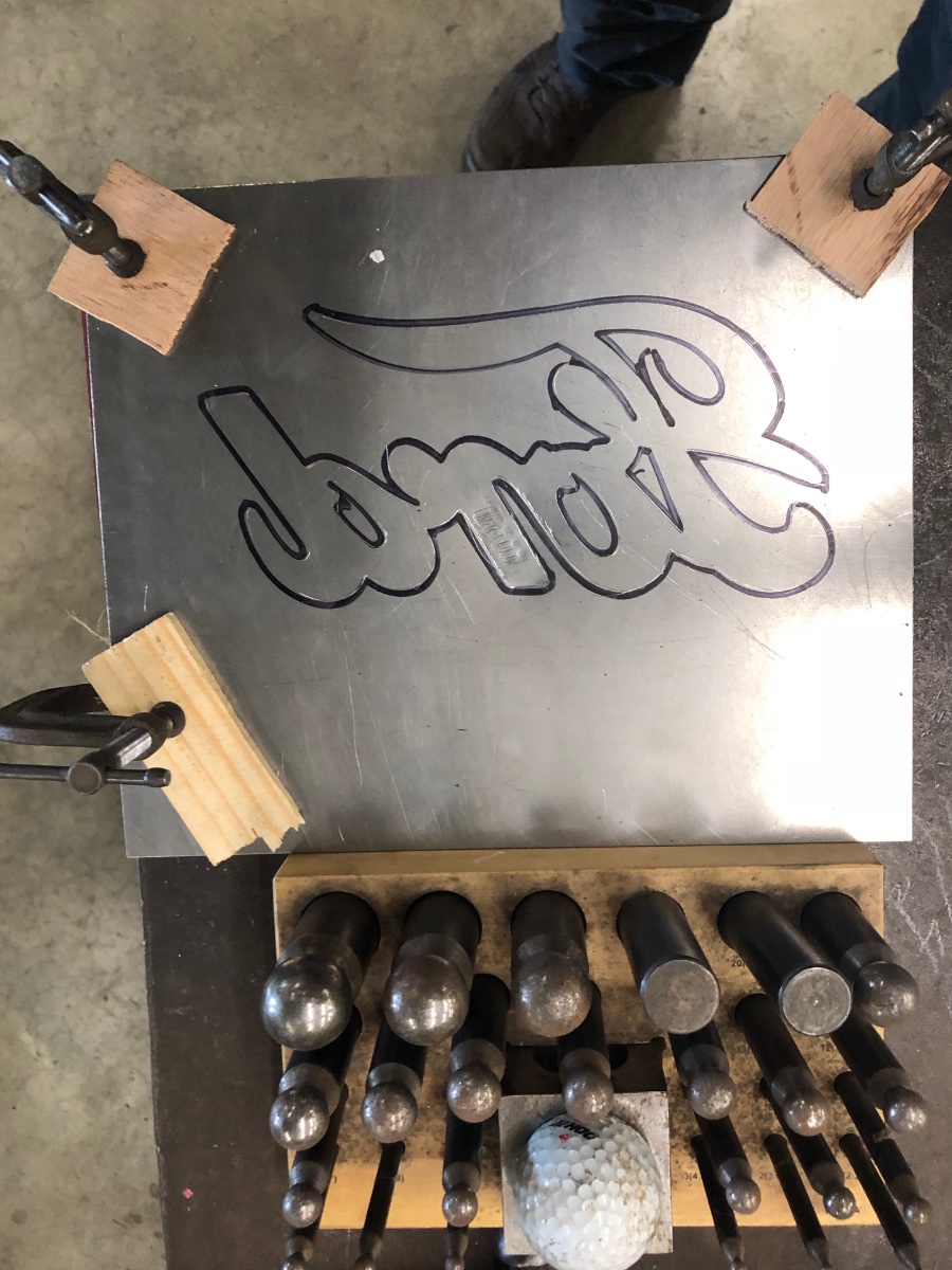

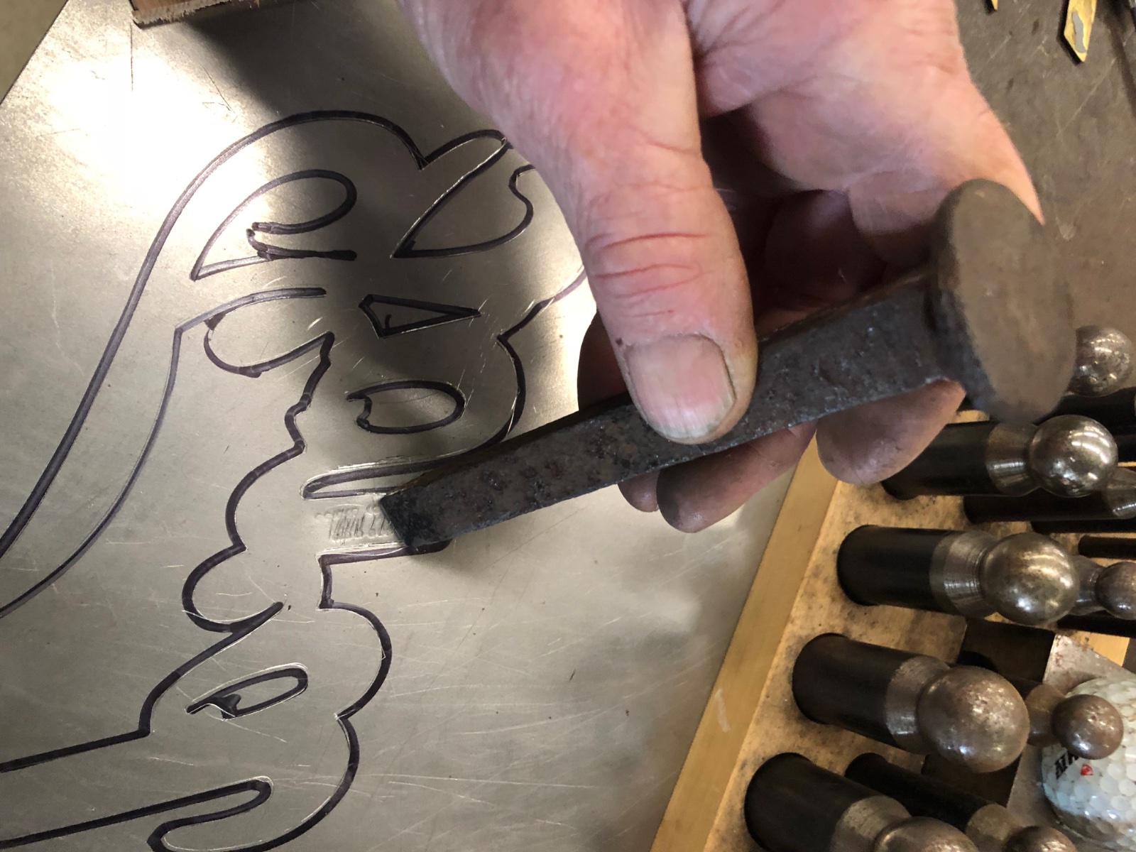

This is a real dying art, craft, skill, just all the above and then some!
Metal embossing, has been around since any metal was formed from ore. Very few are doing it to any extent, just in the old countries like England and etc. To watch a person form from dead scratch an armor suit of mid-evil times is an unbelievable. But think in the era that their metal chemistry was not consistent so hard to soft was common. You know what the apprentice had to do, "Hey kid pound this metal", now days he would say back, "Go pound sand buddy". Past and present!
My tools are about 250 years old and still work like they were made yesterday. Had to drive from the south of England to Scotland to purchase in the 1980's. (Don't ask for pictures of the tools or the process as this is the master's of metal secrets) We are only to give to the apprentice or like mine, they are going back to Scotland to the Museum of Weapons at Edinburgh. They still have an operational course. The students must have 10 years prior experience in multiple disciplines to qualify. Quite the honor and they are PAID students. I was part of a group making the St. Georges Rose on a suit of armor. Absolutely Beautiful!
Enough said, After about 6 hours of layout and beating lightly, the primer and guide coat spray is applied to find minute defects. All must be right before attaching to the fuel tank. I do not make them perfect, and the other side has a slight difference. This shows it was made by hand and not machine.
As I sand the primer (for contrast purposes), the high points will revel themselves so that is where I pick and file the imperfections out!
Enjoy Folks, This is Metal Forming 606.

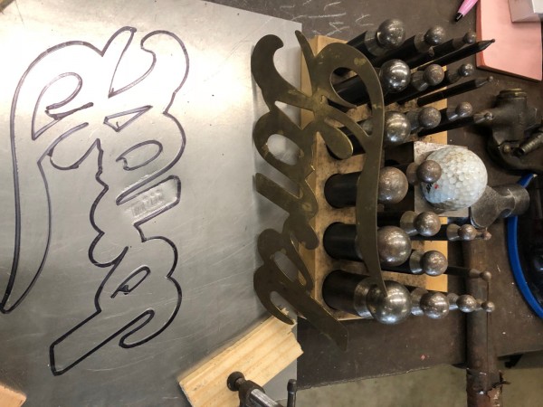

An approach that I have used to obtain “logoing”
To sheet metal is as follows;
I use as much 21st century technology as I can
1. Make a paper drawing and then a digital drawing of the script.
2. Go to my local laser/water jet cutting shop and get the logo cut out in a suitable thickness of steel or perhaps brass
3. Take the cut out and place it on the piece I want to embose. Below put a stiff piece of rubber, perhaps 1/2” thick. Above a thick piece of flat steel and put it all in a suitable hydraulic press, and squeeze.
4. If I’m working on a radiator front or similar then I have just soldered the brass cut out on.
Obviously there are other ways to accomplish this

I’ve done the same as you decribe. However, I have found that plexiglass can be used for the ‘stencil’ in step 2, which means that I can do the cutout and cleanup with simple woodworking tools. And where you mentioned hard rubber, I use urethane, available in various hardnesses for different effects. e.g. softer urethane produces more rounded figures in the sheet material. The plexi patterns do wear out more quickly than metal patterns, they are usually good enough for few finished products, but not hundreds. Annealing your sheet material before pressing or chasing your design into it helps alot, including ferrous and non-ferrous projects.

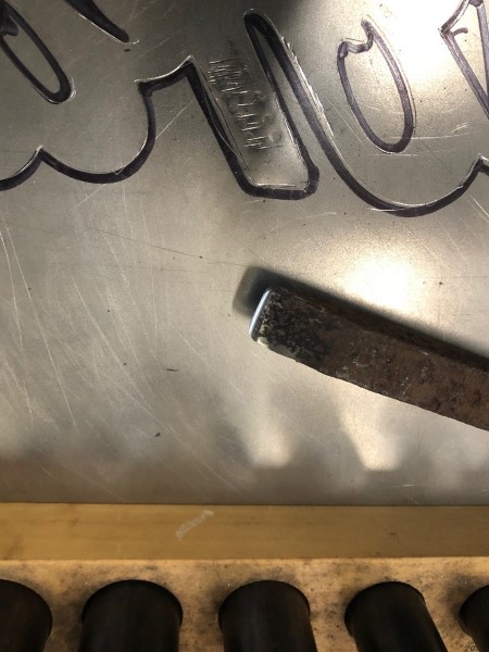

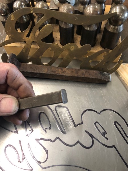

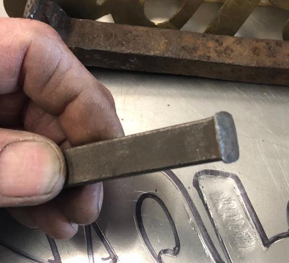

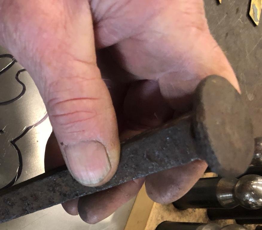

I am going to share some simple tools and process with you all. Look carefully at the photo's. You need a harden ball set (Harbor Freight Tools), an old short railroad spike, old bar stock of various sizes, a good mid size ball pen hammer, 12" X 12" X 1/2" multi layer plywood, some (preferred cloth backed) linoleum, three strong c-clamps, and hopefully you have a steel plate table.
Now after the outline has been established, I like to take a scribe as well to outline better. Taking the railroad spike to a sander rounding the edges since we want to stretch not cut. Lightly strike the outline dead straight on. Note: See how the steel is only being retained on three edges. That's for letting it expand to that open edge only. Now select a round ball punch slightly smaller than the area to be embossed and strike in a slight traveling motion. Keep the angle of strike towards the outside. But starting your work from the inside towards the outside. Keep repeating the process equally as you are massaging the metal. Steel is a different duck as it's shrinking properties are less than other metals. Use the ball punches sparingly as they move metal quickly. Using the old bar stock, rotating the ends back and forth, makes for a long lasting tool. Remember to keep the punches rounded at all times, tearing occurs quick. When you get to your depth required or close to, remove the wood and clamps and very lightly pen with a jewelers hammer. When it looks about right, remove the linoleum a beat straight on the steel plate. Then reverse to do light finish work.
Please note too that legally you can not charge anyone to emboss a logo with trademarks. Ford and others want Big Bucks for some license agreements.
Now don't spend your children inheritance on scrape metal! Make sure if you can, your work area at a waist high zone. This keeps your joints from being trashed.
