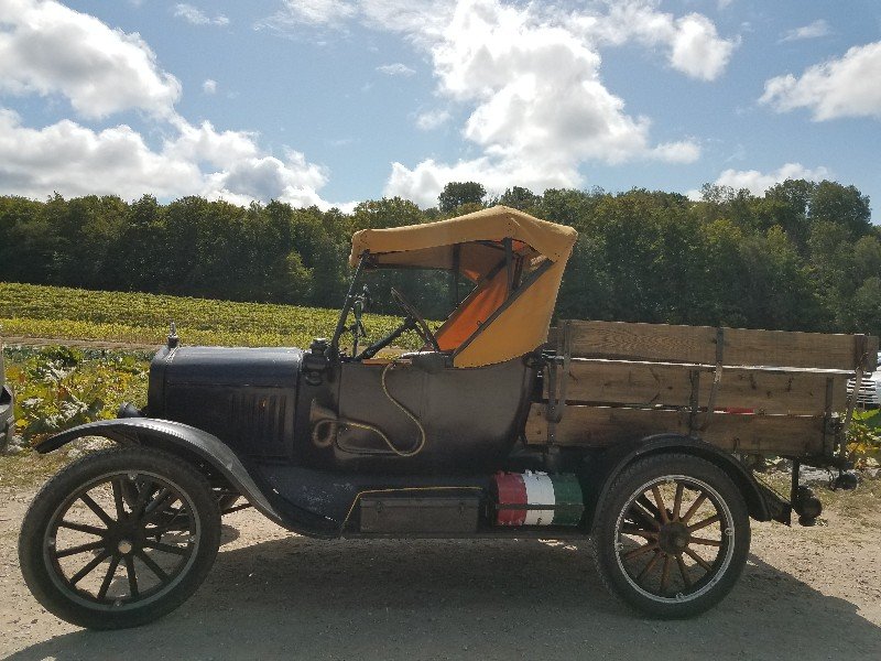

Re: HELP! How to replace 1925 turtle deck with a 1925 pickup bed
Post by dhosh » Sun May 30, 2021 11:25 pm
That's how I did mine, yes. Unbolted the turtle deck, bolted ash 2x4 or better, from side to side, then ran 1" ash deck boards front to back, and lag bolted to the 2x4 'slats'. Hi would have to really dig for some in-progress photos of it, as that was several phones ago!

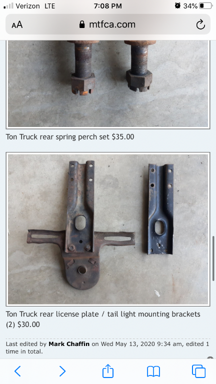

In addition to the fender mount change you will need a commercial type taillight bracket to mount your taillight under the pickup bed. If you have demountable wheels you will need to decide where to mount your spare, under bed, at driver's side fake door ( USA ), or in bed.

Post by Afrazer » Tue Jun 01, 2021 10:44 am
This is the bracket you need. It will attach on the cross bracket bottom of bed that runs against the body. Believe it was attached by riveting.I used a different light then the 26 light that is shown. Bed should attach to body by 3 bolt holes along same body line below roadster deck. I don’t have pictures of mine but could take some if needed

Post by Afrazer » Wed Jun 02, 2021 8:07 am
They were used on ton trucks and the roadster pickups. So they come up every now and then. I purchased a reproduction from a vender.

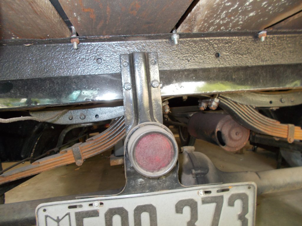

Would someone please take a picture of the taillight mounted on the pickup
Jim Sims
Posts: 181
Joined: Sun Jan 06, 2019 12:38 pm
First Name: Jim
Last Name: Sims
* REQUIRED* Type and Year of Model Ts owned: 17 touring 20 roadster 21coupe 25tudor 25 pickup 27 coupe
Location: Reed City, MI
Post by Jim Sims » Wed Jun 02, 2021 12:58 pm
Lets see if this works
Tail light mount
Tail light mount
Posts: 1967
Last Name: Tannehill
Location: Hot Coffee, MS
Board Member Since: 2002
Post by JTT3 » Wed Jun 02, 2021 1:21 pm
Now I get it, thanks Jim for the pictures
