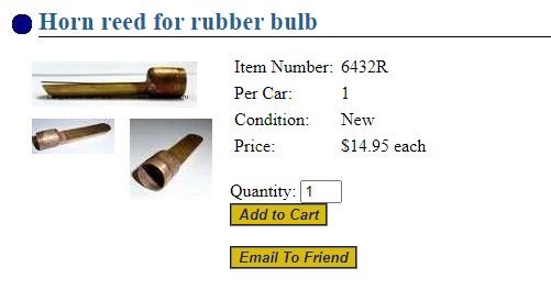

Post by Quickm007 » Mon May 31, 2021 3:06 pm
I face up that issue before and after several trials a gave up and bought brand new one at Lang's. It work awesome now!
Horn reed.JPG (25.56 KiB) Viewed 3363 times
