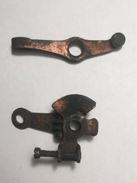

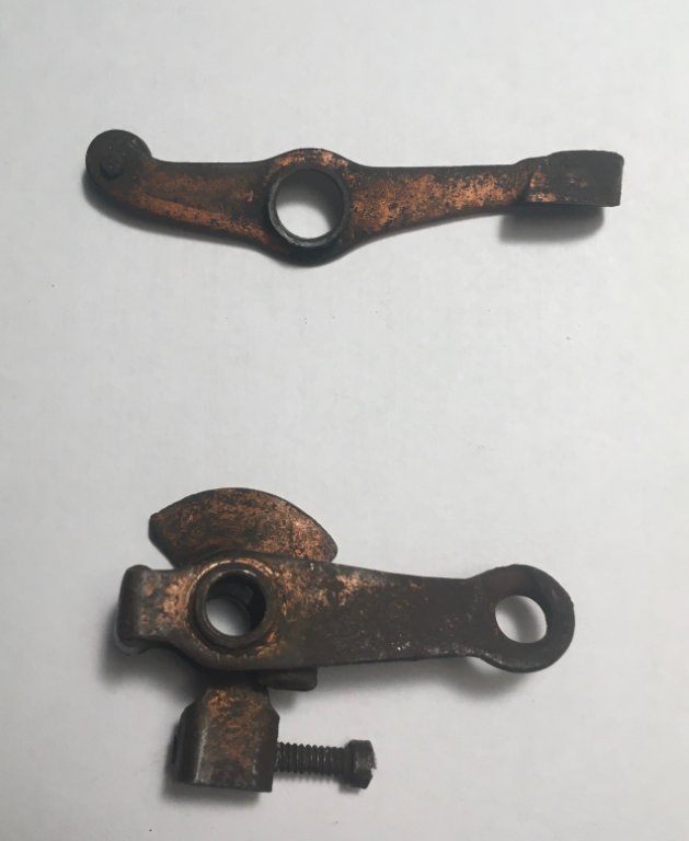

Were Stromberg OF throttle and economizer arms copper plated?
I started cleaning a Stromberg OF, and the throttle and economizer arms look like they were copper plated. I know that Winfield copper plated S and SR bodies, but has anybody seen this on Stromberg steel parts?

Re: Were Stromberg OF throttle and economizer arms copper plated?
They had a pretty thin flash plating on them for rustproofing. It’s pretty uncommon to find one with anything still showing. I do mine in nickel plate, which is copper flash and then dull nickel. Gives them a nice look and rustproofs them.
Thanks Tim! I've never seen copper plating on a contemporary carb, but a "rustproofing" flash plating wouldn't surprise me at all.
- Posts: 6710
I have 7 OF's at the bench and of those, 1 clearly has remains of a copper wash and 3 have the remnants of an obvious brass wash. They are all extremely thinly flashed as mentioned. I think I've seen more brass than copper and that seems to be borne out with what I have right now. I have seen the same thing on the internal economizer spring as well.

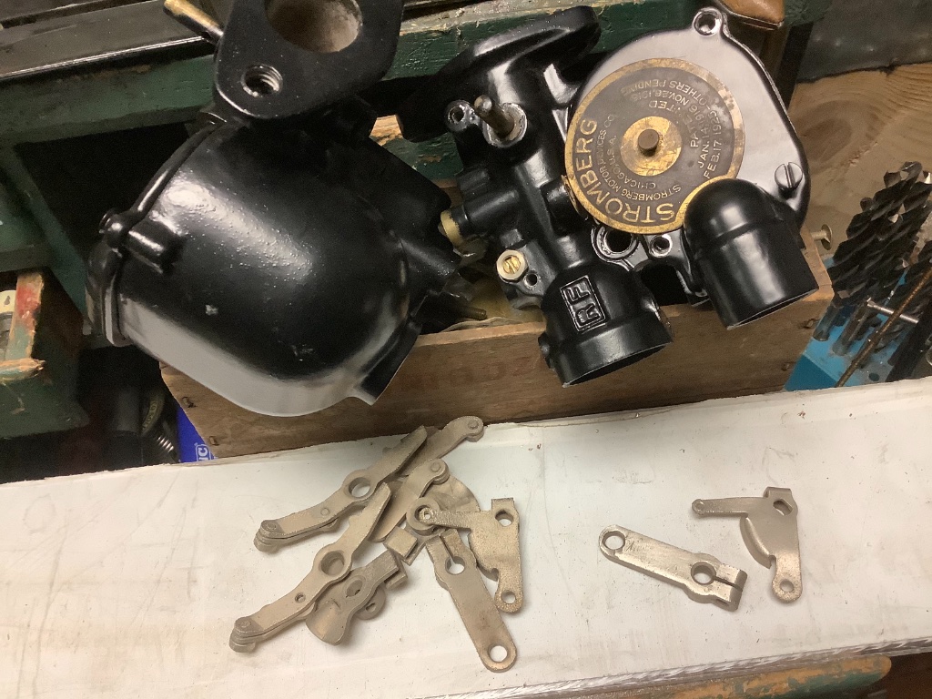

Here are my parts with a quick nickel plate. The two on the right had a quick skuff with a scotch brite pad. The RF had a black painted finish that rarely survived, like the flash plating. I did a couple of my favs in black powder coat. That should be worth an extra MPH !
