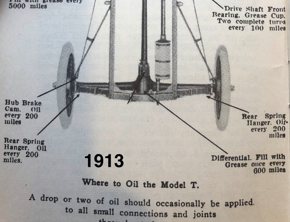

The early Owner's Manual didn't specify the lube amount for the rear axle housing, but only supplied a drawing with the note to "fill with grease", that did lead to overfill and leaking. The fill plug was at mid-line of the housing on these.
So, later Ford re-positioned the fill hole to below the mid-line of the axle, and noted "not be more than 1/3 full" and to keep the level " 1 1/2" below the fill hole.

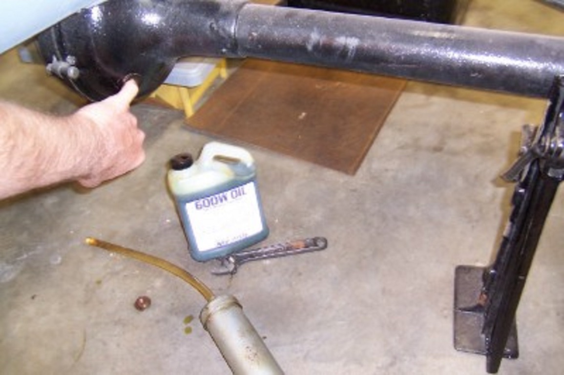

Have done it that way, and used the little pinky to check the fluid level. Some use a bent wire to to it, like a dip stick.
Filling with suction gun, checking with pinky.
