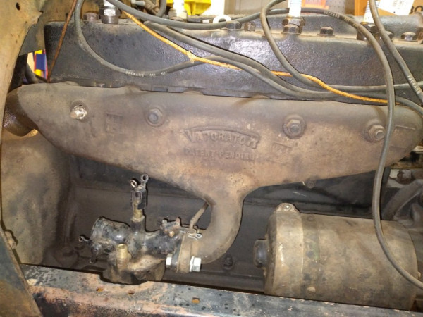

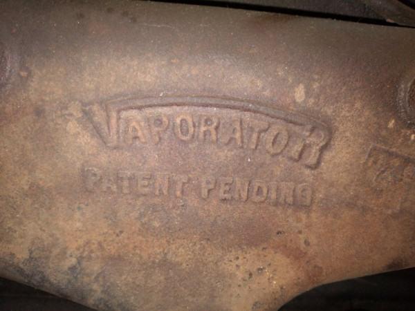

Hello group! I am new to the Model T hobby ( 5 months and on my second T!) and just purchased the start of a speedster. The engine is a 1925 and has a one piece intake and exhaust called a Vaporator. Does anyone have any information as to who made this and what if any performance upgrade it would provide over a regular two piece unit?

There are several period one piece intake/exhaust setups made by multiple company’s & I like them. You don’t have as much trouble with warping and the fuel is heated from the radiant heat. Be sure to inspect the manifold for cracks, leaks & rust through. I had a few on multiple Ts and they worked well. Hope that helps.

Looks like you also have a Waukesha head. Nice!
