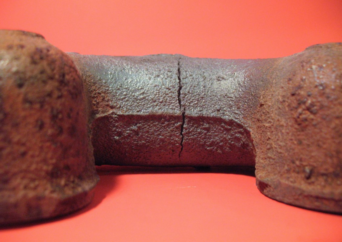

Three of the exhaust manifolds I straightened were so far gone that they didn't survive the process. Would it be worthwhile to vee cracks like this and braze them?

Steve I have plenty of warped maifolds you can have. I used to straighten them but found that I was spending too much time and using more welding gas than it was worth. The repro manifolds are fairly cheap and work great. Other than for the exercise, I would not bother.

I also agree with the others in just replace it however if you are a fix it guy like so many of us are I would use a spray bar to repair cast iron rather than braising it.

Steve, The heat from brazing the crack would likely pull the manifold the wrong direction, and you would be back where you started.Darryl

Daryl raises a good point. I think it would only work if you can make whatever weld you decide on with the manifold and glands bolted to a decent jig, to keep everything in line.

I have seen exhaust manifolds brazed, and work fine. However, generally, model T manifolds can get a bit too hot for brass. A nickel bronze braze might be a bit better. Still, exhaust manifolds are better done either by actual cast iron welding, or the metal spray mentioned by Scottio (at least I think that is what he is referring to?). I have never done that myself, however I watched a demonstration up close of it being done and was quite impressed by it. I had hoped to get the supplies, but couldn't afford to, although the basic kit isn't (wasn't?) very expensive.

If you really wanted to attempt it, couldn't you stick it onto an old block, and work on it there? It CANT move out of line that way.... ??

Steve, it may be worthwhile in other ways than money. Weld or braze, not sure which (I've never personally brazed before). I am curious how far the non-visible crack goes and might even break it the rest of the way before repairing.

In the '60's was hard to find a repro manifold.. had one like that cracked, in the same place, and took it to a shop for welding.
Came back with a big cast iron weld all the way around, about 1/2" wide and 1/4" tall. Looked odd, but no leak there. But was out of alignment, so used the flat asbestos gaskets back then, seemed to work out.
Today, I would just order a new one!

Brazing won't work well on a exhaust manifold. An exhaust manifold can get red hot with the spark retarded.

Re: Welding advice: Is it worth trying to fix?
