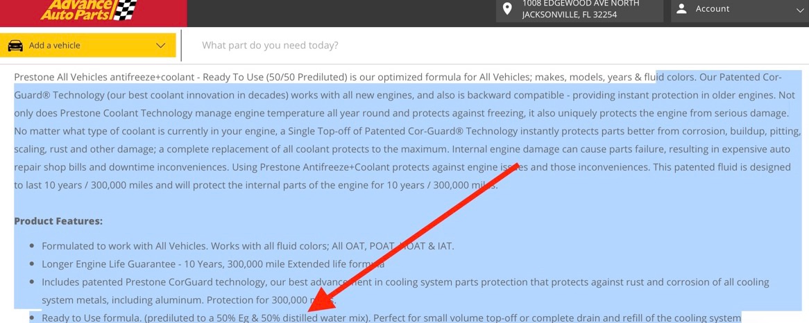

- Posts: 4113
Re: ALUMINUM HEAD ANTIFREEZE
Really not rocket science
The solution of water and anti-freeze is dependent on your weather needs, read the back of each container and it will give specs of what % of anti-freeze and water for your T's needs.
Typical is 50/50. Since I'm in FL, my preference is mix of more water than anti-freeze, and never cooling issues. Also, I flush and refill every two years. Each time a bit of rust comes out, just happens as our T blocks and heads are decades old and will just deteriorate over time. The only way to stop the decay of time is to put the T in a museum, drain it, and fill the cooling system with oil! That will stop rust inside.
Same with aluminum high compression heads, just use anti-freeze, the formulations prevent alum. damage.
A self destructive anode, added to the cooling system, will just decay in the closed system of the T, and clog the radiator.
As for distilled water, that is the best to use. Tap water will contain stuff added, like chorine and fluoride, and other drinking water stuff. We are on a well, and that water is good but has iron. Distilled is clean, and pure. Not the same as 'deionized' water that is negative. But regardless, we don't run 100% water in the T system, if you care about keeping rust down. Add anti-freeze for corrosion protection, and freeze, or add soluble oil for corrosion protection.
BTW, if you purchase "Premix 50/50" in the container for ease of use.......that "premix" is mixed with distilled water!
Prestone: Click on image to enlarge to read detail.
