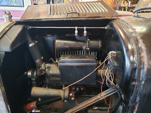

Be kinda hard to detail it out. I can take pics when done, hopefully this weekend. I plan to use the mounting bracket that came with the horn that has two points to mount so the weight of the horn will be over two points on the rod. Using stainless wire rope clamps and two stainless L brackets to adapt. Found a neato double throw ON-OFF-ON under dash clamp switch so no permanent holes to drill and I can choose the AHOOGA or the stock horn to activate via the stock button and switch between the two horns.

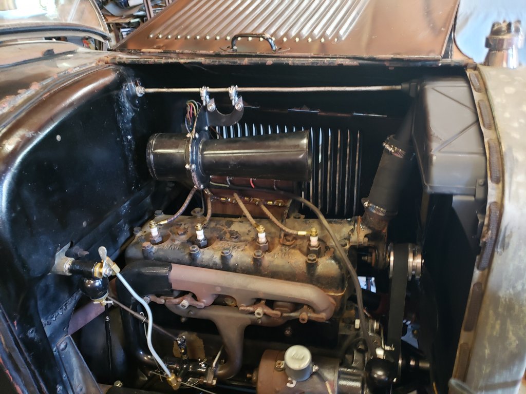

Post by Mikey1968 » Sat Jun 05, 2021 1:02 pm

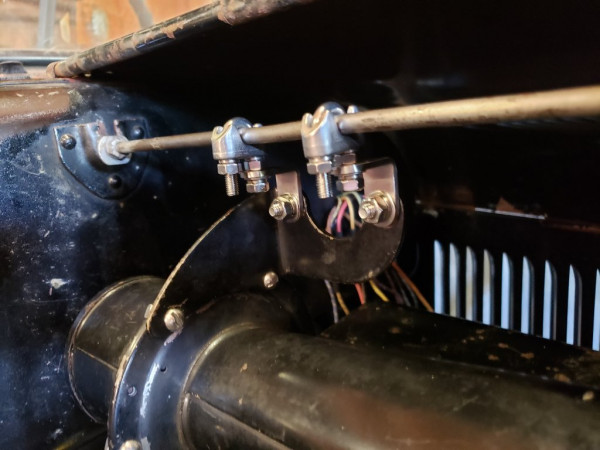

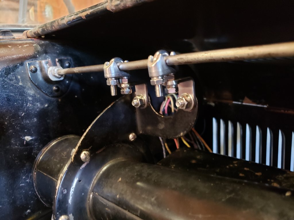

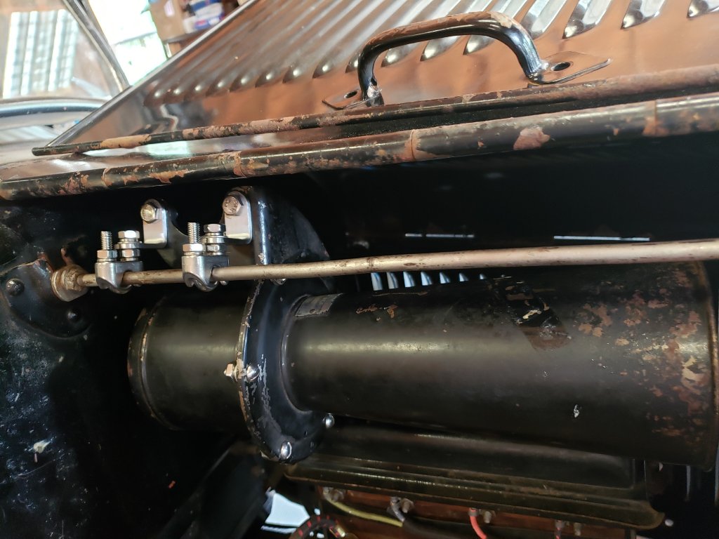

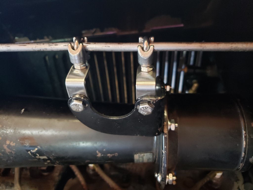

Here's how it looks right now. Getting too hot in the garage to do the wiring....sighhhh. Had to drill out the angle brackets to 1/4" The rope clamps are M8 5/16" All stainless steel.
Posts: 6790
Re: Mounting Horn on Radiator to Firewall Rod
Post by Scott_Conger » Sat Jun 05, 2021 1:38 pm
Michael

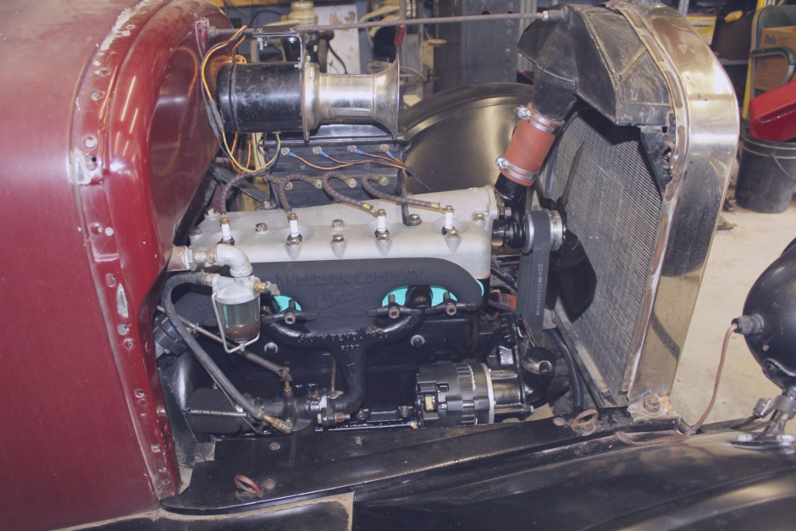

now you need to send that picture to Berg's Radiator and ask them if they will warrant their product with that thing boinging around the way that it will. You may believe that your horn is mounted like Pat Kelley's, but it is not.
His due to the type of horn and it's relative location as mounted, weight distribution is far further aft than yours. Neither is ideal, but yours is going to be far more flexible and much harder on the radiator.

Post by schwabd1 » Sat Jun 05, 2021 10:22 pm
Couldn't that mounting bracket be rotated 180 degrees so the mounting point would be closer to the firewall? It seems weight distribution would be better too.
Posts: 5246
First Name: john
Last Name: karvaly
Location: orange, ca
Post by speedytinc » Sat Jun 05, 2021 10:37 pm
Keep an eye on those thin little L brackets. They are ripe to crack.
Posts: 7269
Post by Allan » Sun Jun 06, 2021 6:36 am
Are the L brackets necessary? The horn bracket could be mounted directly onto the cable clamp U bolts. This will shorten the mounting and enable the horn to be mounted more to the rear.
Post by Mikey1968 » Sun Jun 06, 2021 9:58 am
Hmmmm...lots of good thoughts. I put the bracket the way it is to try and balance the horn but it could be reversed if you guys think it would make that much of a difference. I did the L brackets so there would be less torque on the clamps and avoid the chance of the clamps slipping. Those L brackets are a little thicker than the stock bracket so I figured they would be fine...3mm thick stainless. Again, I could mount without the L brackets, though....it would give less a lever arm as well.
Won't be driving it any time soon so I will think on it. Might change it around if it's not too hot today.

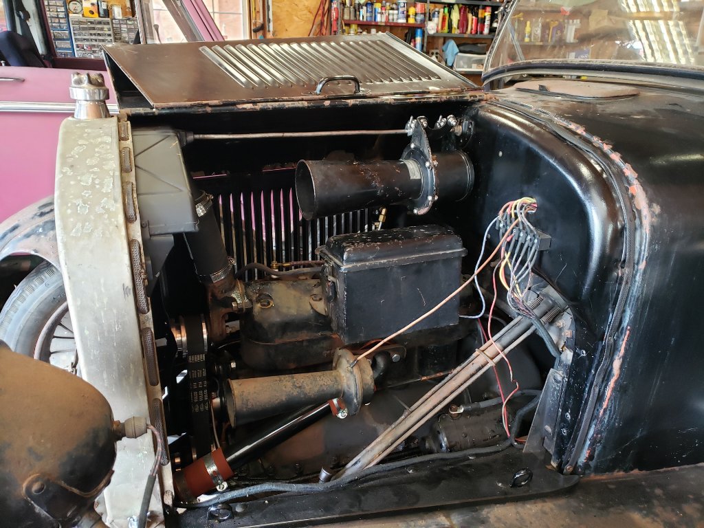

Post by Mikey1968 » Sun Jun 13, 2021 10:07 am

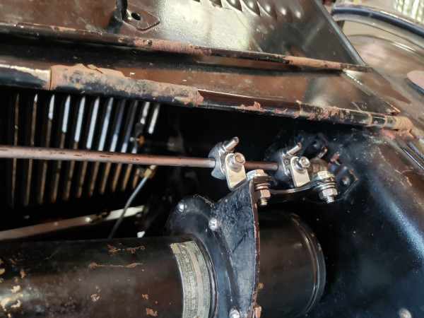

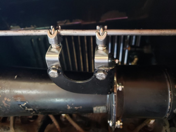

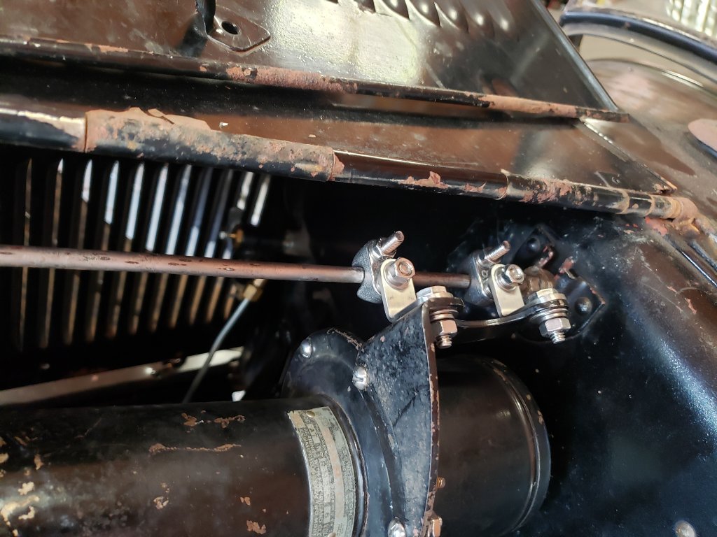

I was able to flip the bracket but I couldn't eliminate the L brackets due to the offset of the original bracket. That offset pushed the horn into the coil box so I had to raise the horn up to provide clearance. Also had to give it a bit of a rotation from the vertical. What do you think? Better?

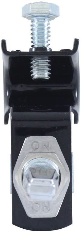

Post by Mikey1968 » Sun Jun 13, 2021 10:15 am

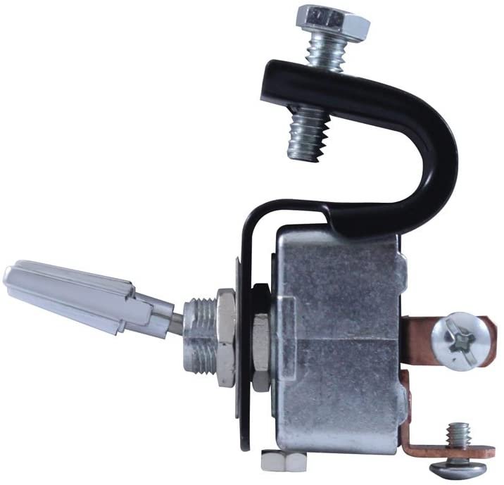

Here is a nifty switch I intend to wire up to choose which horn the button will activate. Turn the switch sideways and you'd get a nice discrete turn signal switch!
