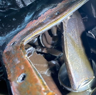

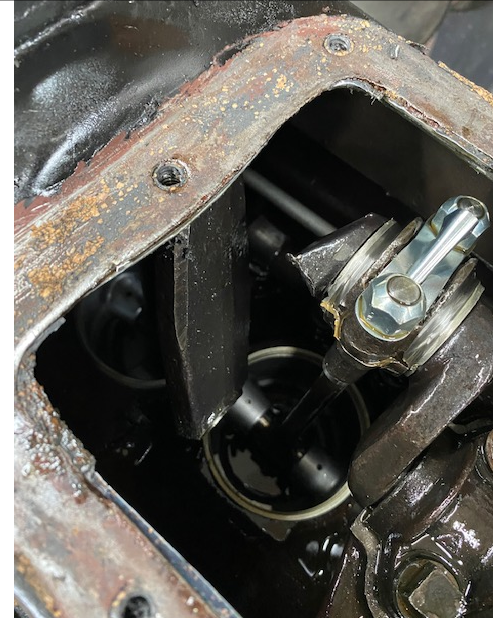

It's MUCH worse than just a broken crank!
Post by vech » Fri Jun 04, 2021 9:46 am
I just noticed, as I was getting ready to take the pan off, that it shattered the rear bearing webbing of the crankcase. :cry:
I am now on a search for a 1915 block. This block is not repairable... What a bummer.....
Anybody out there have a good 1915 block they would sell? HELP!!!

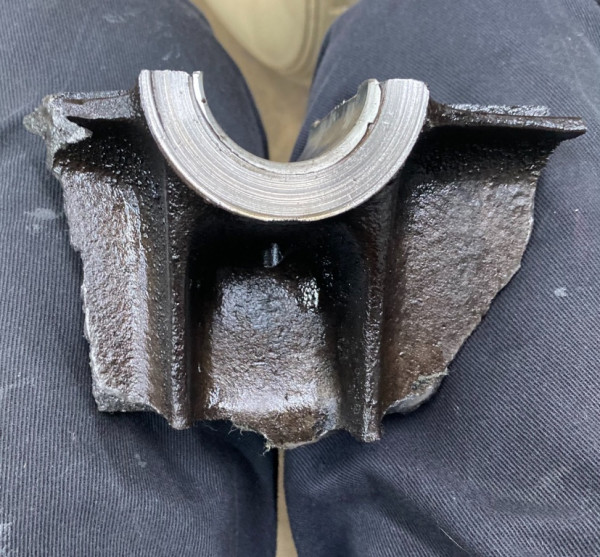

I have the engine completely torn down now. I found another 1915 engine, right here In Mississippi. I want to thank everyone for their help. This is the broken out web of the rear main bearing. When the crank let go, it destroyed the block…
"If a fly can, a flywheel" :shock:

Hey the bearing looks Good??
I did the same thing with my '12 block over in Kanab 2 tour several years ago and have it running in my car now still and heading up to the National Tour in Spokane soon. I know it's not the normal repair but I "cold" welded it and reinforced it with a JB WELD sandwich front and back bolted together with a plate bolted on each side! It's been doing really good so far.
I have a replacement '12 block but this original one is still going strong... Amazing what you can do sometimes!

I know it's hard to judge by a photo online, but some of that break looks like it was rubbed around. Allen's posting may be what happened.
Sad event, sounds like you have found the parts to fix your car.

Craig, can you post a photo or two of the surfaces of the breakout. If the crack originated from the land on which the main bearing bolts are done up, it may well have been dancing about a bit before it finally let go. If this is the case, the crack next to the bolts will be somewhat polished as it 'worked', while the last bit of the break will appear a clean break. This is not uncommon on the early blocks. I have personal experience of at least 3 breaks of this type.
One engineer in our club had the rear web welded back into the damaged block of his 1912 T. With new bearings poured and a replacement Ford crankshaft, the car is still going strong, so all is not lost.
The machinist in the machine shop I use for all my T engine work indicated that the sharp termination between the back of the block and the face on which the bolts/nuts register, is a perfect stress riser, and the cracks/breakouts I have seen indicate that this may well be the case. He suggested that the transition between the horizontal and vertical planes at that point should be well radiussed, just like the radius employed when the crankshafts are ground.
For this reason, I pay particular attention to that area on any block on which I work. Now I will not do customer jobs without having the block crack tested.

"If the crack originated from the land on which the main bearing bolts are done up...." /// Photo of this area?
