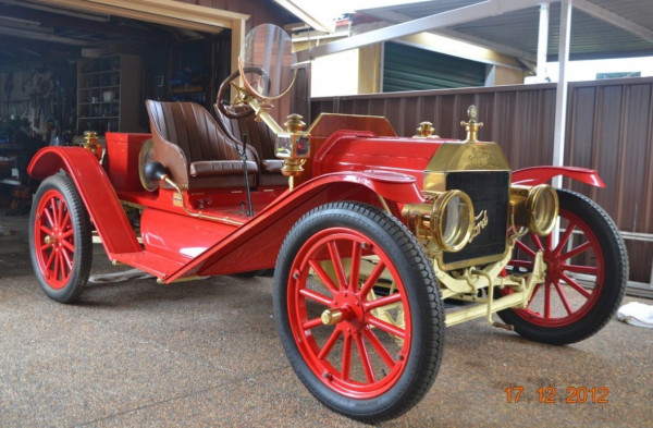

I live in Melbourne, Australia and have a lovely 1914 Speedster.
