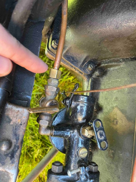

As far as the problems I’m experiencing, I bought the car a couple weeks ago. Seemed to run well but being unfamiliar I stalled several times. It was also leaking fuel from the shutoff valve. I tightened what looks like the compression nut leading into the valve and losened the needle for the carb. If I let it sit for a while it will start and run for about 20 seconds and cut off. Then I can’t get it to start again.

The cut-off valve you refer to - is that the one on the sediment bulb under the gas tank? Or, is it a shut-off valve mounted on the carb fuel line itself. If you are unscrewing the carb needle valve you may be over-richening the fuel mixture. What year is the car? Some photos of the carb might be helplful. I'm sure others will chime in but it sounds like you could have a fuel issue and it might be simple to solve if we had a bit more info. If it starts, then runs a bit and stalls, you're not too far from running and enjoying it.

Thank you Terry. Its the cut off valve at the carb fuel line. (finger pointing to it in the pic)

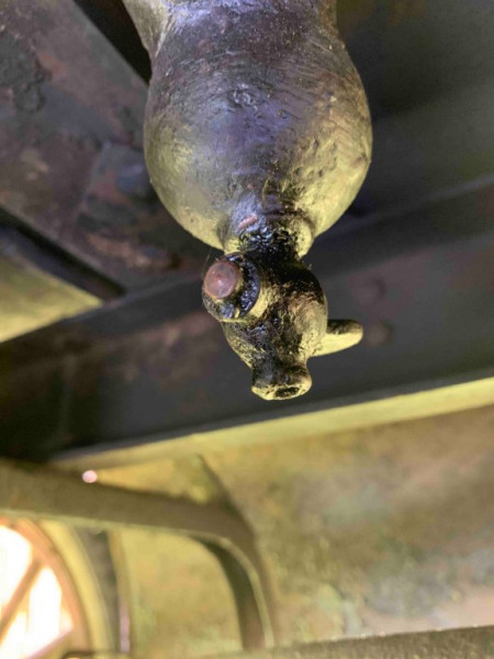

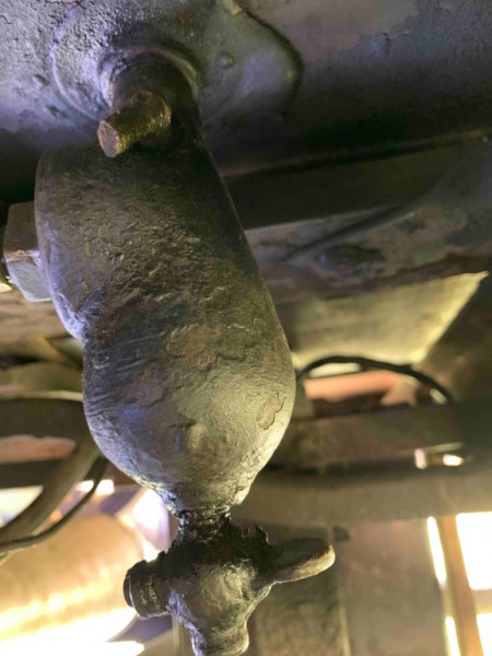

After reading some more i closed the carb needle and opened it a full turn. I have a 1924 Tudor with a Kingston carburetor. I tried to open the sediment valve under the gas tank (picture below) but wasn't able to. Need to figure that out too. It also looks like the shutoff valve arm at the top of the sediment bulb is broken? seems like just a nub.

You probably turned off the fuel before you took the photo but the valve is in the fuel off position isn’t it?

Correct. The fuel line was open but I closed before taking the picture.

sediment bowl valve handle is broken off in mostly closed position
once car is running, you will want to repair/replace it as you will never achieve proper fuel flow for prolonged hill climbing or any sustained speed.

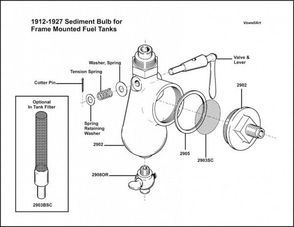

This is what it should look like.
Take a look at the MTFCA Main WEB page under the Research TAB. Lot's of good information there.

You can GENTLY tap the spring side of the valve handle & turn the stub to down. That will restore full fuel flow, so you can run it untill you get a new sediment bowl. You gotta be chomping @ the bit to run it, I would be. Running out of gas in 20 minuets is from that fuel valve. Lets not forget to replace that copper fuel line & compression fitting with a steel line.
Under the sediment bowl is a drain petcock. May need a little tap to open also.
