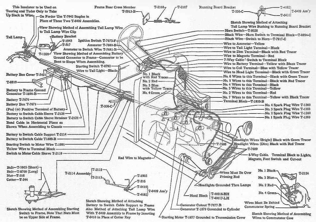

Your problem could be that the wires to the headlights are crisscrossed at the headlight thimble, assuming that they are correct at the terminal block.
Battery headlights are connected in parallel so if you have the bright wire to left headlight bright connection and the dim wire the dim connection, but the reverse on the other other headlight, you would cause both filaments on both lights to be on regardless of the switch connection. The circuit being completed at the terminal block regardless of which way the switch is turned. Disconnect all the headlight wires at the terminal blick and reconnect one at a time to see the result.
Topic author - Posts: 8654
Re: 1926 Headlights 6V, Generator & Starter
Frank: The headlight wires are black with tracer stripes. They appear to be correct at the terminal block, but they could be reversed at either thimble. I noticed that the left light seems to dip a little when switched to hi. The right side behaves normally, with a better focus pattern and a slight dip on "Dim". Maybe I need to reverse the wires at the left thimble. Both plugs look to be oriented the same relative to the bracket, with both contacts nearly vertical and lined up with the stem of the bracket. I believe the filaments are oriented \ \ //. I'd think = = would be correct as John indicated.

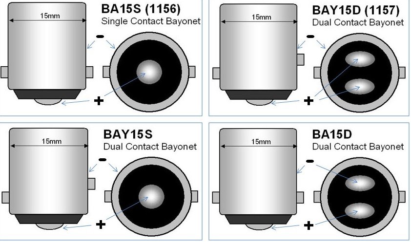

PAT. THE LEDS I USE COST ABOUT $9.00 EACH. AND HAVE A HIGH AND LOW brightness and plug and play with OEM switch and wiring. there are a number of LED headlight bulbs for 12 volts but no so many for 6 volts. But if You want to try a pair of LED bulbs I have tried three different types and like this one the best. which also comes in a 12 volt version. unlike the LEDs Alan mentioned they are indeed white 6000K not blue. they are bright but not too bright 70/40 c.p. versus 50/32 c.p. vendor replacements. they make a wedge shaped bulb 5 -30 volts ac/dc a number of folks have used. I think they are too bright and produce a funny c or u pattern depending on socket set up.

My guess is that they are reversed at ONE thimble, thought it might be easier to diagnose from the terminal block is all.TXGOAT2 wrote: ↑Tue Jun 08, 2021 11:14 amFrank: The headlight wires are black with tracer stripes. They appear to be correct at the terminal block, but they could be reversed at either thimble. I noticed that the left light seems to dip a little when switched to hi. The right side behaves normally, with a better focus pattern and a slight dip on "Dim". Maybe I need to reverse the wires at the left thimble. Both plugs look to be oriented the same relative to the bracket, with both contacts nearly vertical and lined up with the stem of the bracket. I believe the filaments are oriented \ \ //. I'd think = = would be correct as John indicated.

Frank: I find that the thimbles will fit either of 2 ways in the socket. They were installed with the red tracer wire lowest. I tried reversing the left one, putting the yellow (?) tracer lowest and that corrected the backwards behavior of the beam. The wires are correct at the terminal block. I now have both beams in sync, dipping slightly on Low and raising slightly on High. I'll reverse the wires on the left thimble for consistency. I had no idea the thimbles (plugs) would fit the socket either way. They were probably correct when I got the car. The focus is not perfect, but it is fair, and the lights are suprisingly bright with the engine off. Current draw remains high, but I attribute that to the upgrade bulbs. I'm going to let the battery sit on a 1.5 A charger for the rest of the day, then see how things work tonight, if it isn't raining yet again. With the battery (6 V Optima red top) topped off, the generator may be able to hold a 1 or 2 A surplus with the lights on. /// /You folks who are having record heat and drought conditions, your normal weather has been here in Texas for the last several weeks. The NWS says it is leaving here by the end of this week, with 104 F predicted here for Friday. With everthing soaking wet, the humidity and heat are going to be a killer. Another grid emergency may be in the works, especially if winds are low area wide. //// Thanks to all for suggestions and information.

Pat. I bought them from LEDLight.com 1-877-283-5060. SKU # 87455W 6v led headlight BA15D 60 SMD Dual filament. color: white 6000K
price about $9.00 each.

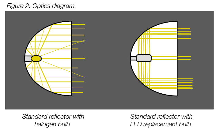

A few more points about T headlights - Fluted lens and the reflector's focal point that effect light projection
By Fred Dimock, Newfields NH, USA on Wednesday, June 19, 2013 - 08:59 am:
"One thing that many people miss is the location of the bulb filament in relation to the focal point of the reflector - which in most cases is a parabola.
-In the US the filament was placed perpendicular to the axis of the reflector and it produced a bow tie light pattern.
The fluting on the glass lens took the upward left light and sent it towards the down right.
-In Europe the filament was parallel to the axis and it produced a cylindrical beam of light.
They used a shield to block the upper left light.
OH Ya- In case you didn't get it. -Upper left light is bad for the oncoming traffic. The high beam filament was usually placed off axis so the light would go towards the upper right and left. Not that I know anything about automotive lighting after spending 10 years in the industry!"

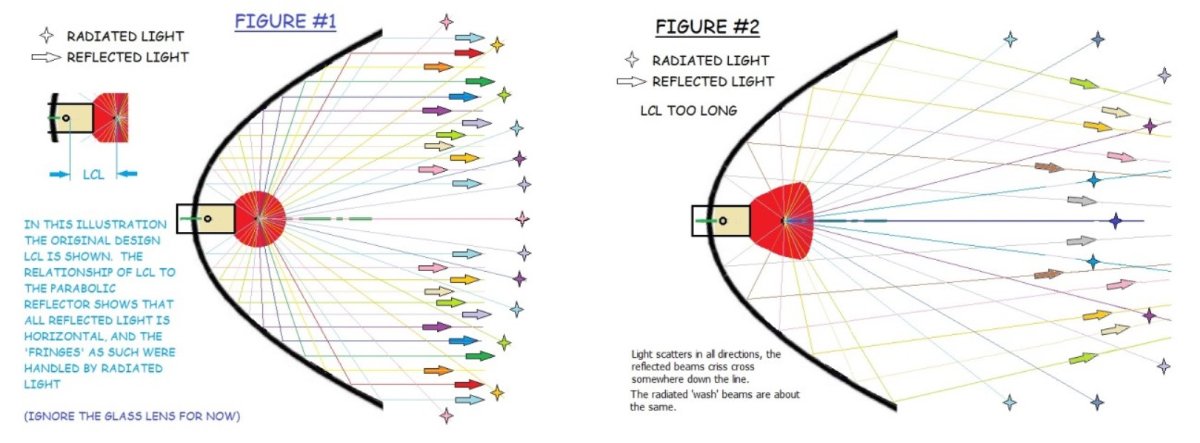

By George_Cherry Hill NJ on Thursday, June 20, 2013 - 02:43 am:
"...Once all else is fair and square, there is one point and one point only where the lamp is in the right position on the reflector. The adjusting screw provides for a little...but there was what is called the LCL distance of the original style lamps.
This is the distance from the focal point of the filament to a reference point on the pin. We do not know what this is for Ford lamps as far as I know...but MAZDA in the era said in advertising that their 1129 for single filament or 1110 for dual filament was the proper interchangeable replacement lamp (in the spherical '10' size glass) lamp for Ford cars. Ergo unless it was PT Barnum and they were not as bright a thrown beam as OEM, perhaps the same LCL by definition if they were?
So play away with bulbs and sizes all you want, the LCL just has to be the same as the parabola was designed for or you might just get brighter in some places and darker in others and not able to adjust it out.
The lamp number series is now about 85 years old, and the purpose of the standard was to issue a unique set of specs for each number, not just candle power.
I'm not near any of my lamp books, but do know some have here even have more lamp reference books than me. Find the LCL number for these MAZDA lamps shown...and then any other lamps having the same LCL will match the parabola. Feel free to play with CP and lamp light 'color' all you want at that point.
"Once upon a time" in another of my Don Quixote quests that never got quite finished because something got in the way, I drafted up a manual of how to get the best illumination possible out of old stuff, even resorting to modern standard lamps and how voltage rating played with light etc.
Shown here are cut number 1 and 2. It shows how the light sprays with a proper LCL (figure 1) and how the light sprays with the wrong LCL (figure 2) on a good reflector. On some lamps you just don't have enough adjustment to make a bad LCL good enough to work right. An example of what you might expect from some LED bulb designs Socket bases

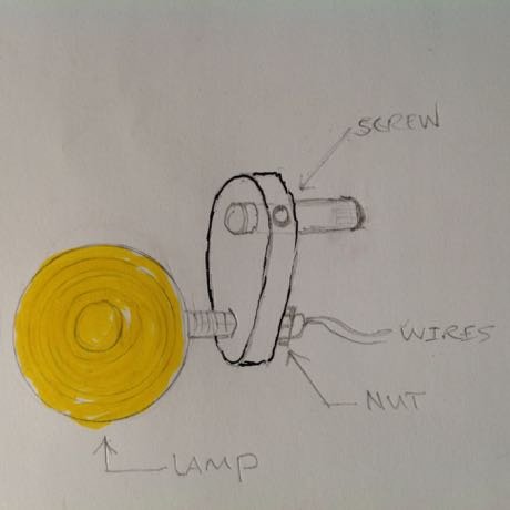

PAT. if You want a lot more light to the rear and Your roadster has the side top tie down posts. the vendors sell a bracket for mounting OEM tail lights on the side posts. I had some brackets made that fit the side posts on the 26 touring and I use Harbor freight trailer lights dual face red rear. amber front. much better visibility to the rear and front. or You can use single lens with just red to rear.
- Attachments
- Lamp Bracket.jpg (19.12 KiB) Viewed 6711 times
I don't have the bow saddles, but I mean to get some so that I can put the top down. That would give great visibility from all angles, and I could use the 2 wire flat trailer connectors to hook them up, making them easy to add or remove as needed. The amber-red would probably be a good choice. I'm pretty sure it would be legal. A lot of cowboys put similar lights on their headache racks.

I tried out the lights last night with a fully charged battery and the wires corrected. The lights work pretty good, with a definite high/low beam. Reflective signs a quarter mile or more down the road will light up. Light in front of the car is fairly bright. The lighting is not as good as decent modern lighting, but it is probably as good as it gets with stock headlights and incandescent bulbs. The 1-2 amp discharge issue with the lights on at road speed remains. I think that is just the way it is with the Mazda 1000 bulbs and the generator charge rate set at about 5-6 amps. If the ammeter is anywhere near correct, the lights draw about 7 amps with the engine off. At any rate, the indicated discharge with the lights on and the engine stopped is a little higher than the indicated charge rate at 1500 rpm+. I can turn up the generator to 9-10 amps, but I'm pretty sure that would mean battery trouble. I wonder how much horsepower a generator consumes pushing 10 amps at 8 volts? That's only about 80 watts, if I'm doing the math right. Not much power.

I think what I need is 32/21 bulbs, if such exist. The bulbs I have do indeed pull the same current regardless of which filament is lit. The 50/32 would no doubt give better lighting, but would aggravate the problem of too much current draw. I seem to recall that a straight series electrical circuit's current draw is a function of voltage applied and the combined resistance of all devices in the circuit provided that all such devices are themselves in series. If that's correct, I could easily add some resistance to the Dim circuit at the terminal block. That ought to reduce the current draw, while of course dimming the light output . By selectively adding resistance, I could de-rate the "Dim" filaments to about 20-25 cp. That ought to allow the generator to feed a small charge to the battery as long as the lights were on the dim setting. I'd have to try it to see if the headlights would still be useful at the reduced output.
Novice
- Posts: 643
- First Name: Jim
- Last Name: Davis
- Location: Tomball,Texas
Pat. Before You go to all that trouble. just use stock OEM 21/3 cp bulbs till You figure out which way You want to go.
- Posts: 7292
Twin filament bulbs usually have two different wattages. However, the lower watt low beam filament is so arranged to throw the light downwards on low beam because, when properly focused, the reflector does its work. This is why replacement modern bulbs are problematical because the filaments are set at 90 degrees to the proper orientation. This orientation is also not achievable with the less than pinpoint source of light from LED replacements with multiple light sources arranged in different patterns.
