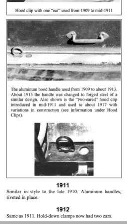

Aluminum handles, cast and riveted are correct for early hoods.
The first '09's up to 2500 or so used steel hoods, likely steel handles.
From late '12 (1913) the handles were changed to iron (steel) and riveted, later were pressed steel formed with the hood.

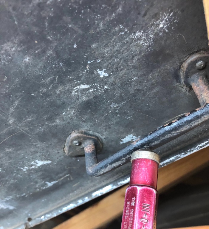

Magnet hanging from the forged steel ( iron )handle of a '13.
