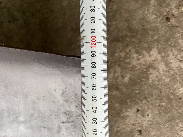

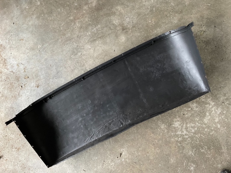

SO, back to my question. Most of the parts are coming together as they should, but the back panel of the font seat I have doesn't fit. I may have been sold the wrong part from the wrong year, or I might not be understanding how to use it.
Even though I don't have the seat or seat riser, I do have measurements off this wonderful forum and those seat measurements make sense when I look at my chassis with running boards and splash aprons.

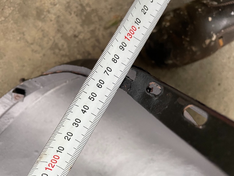

HOWEVER - my seat back panel is waaaaayyyy too wide. I understand the seat back panel doesn't come all the way to the floor but I still believe it is still too wide.
My seat back panel widths are:
Top - 1287mm
Bottom - 1187mm
The measurement I have for the widest point of the seat is 38.25" - 971.5mm.
This panel defines the locations of the panel between the tourer doors and the one I have seems to be around 8" too wide at the lowest point for the subframe I need to build. It is far too wide for the splash aprons.

Jack if that was my car and I wanted it to be a decent looking driver car I would cut the panel in the center to make it the correct width and use the piece you cut out for a backup strip and attach to the inside of the panel. It could be tack welded in place and the outside joint could be filled in with body filler. It wouldn’t take but a little to fill it in and a good body man could use a wire feed welder to weld it shut and then be smoothed out. Just a tip from a farm boy who grew up fixing things the best he could with what he had!

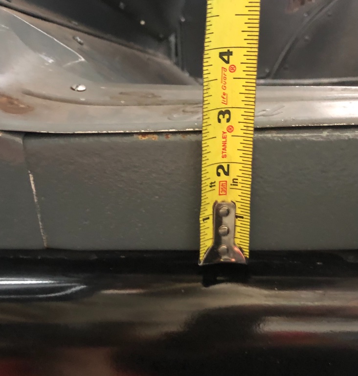

Height at lower rear door to body edge.
If you meant the width (across the body sill) then the width for in rear door lower body edge to opposite rear door body edge is approx. 43”.

I got 1098 mm to the outside of the bottom of the body where you described. 1143 mm across the door sill. BTW: I like those side lights!
