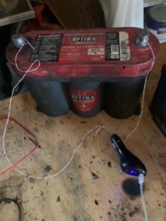

My first effort was a cheap plug in lighter to USB socket and it did not function. No charge showed on the phone display and it took less than 0.01amp.
Next I tried a more expensive converter and it functions correctly.
Here is the set up: After running for an hour or so to see if anything got too hot, the phone had charged from 54% to 80% Now I have to install the parts in the Coupe. I found a screw under the dash board to mount a phone holder and tomorrow I go searching for a cigarette lighter outlet that will be out of the way of my knees.
As to why one functioned and the other failed I could hypoithise that the cheap one had a seven volt zener diode to drop the normal 12v to 5v required by the USB specification. Naturally this will not function on only a six volt input. Again I suspect the more expensive device has a DC-DC high frequency inverter and copes with the 6v input with no problems.

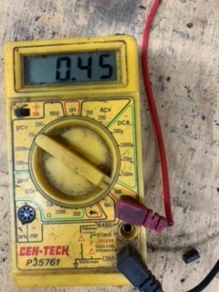

- Current draw of half amp

- Set up

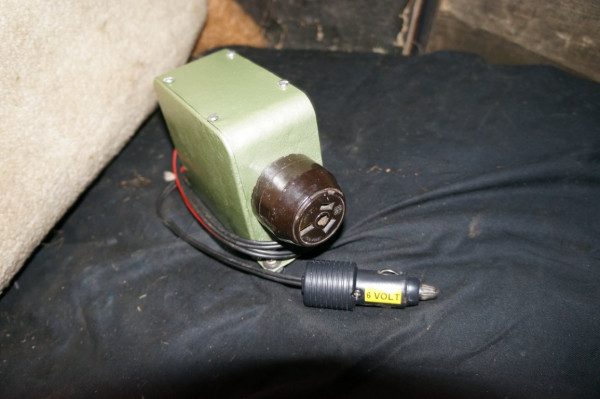

You can buy 6 to 12 volt converters online for under $20. I have them in my T's for phone charging, Garmin, etc.

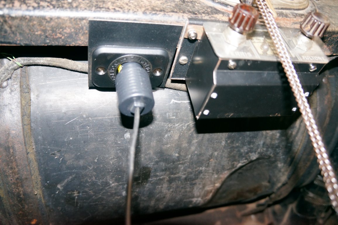

Paul Shinn did this on his YouTube channel to one of his Model As.
He bought a certain plug in charge receptacle and wired it directly to his battery.
The plug receptacle looks like a cigarette lighter or power source in a modern car

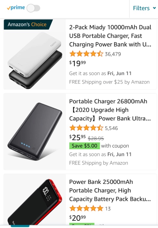

When the subject of phone chargers comes up periodically, I always recommend picking up a USB portable power bank battery pack. They fit in your pocket and for around $20-25 you can pick up a decent one. You can take it anywhere and it will eliminate unreliable power converters and running wires in your T. To me it doesn’t get much easier than that.

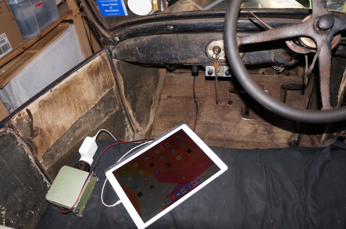

I use a 6 to 240V inverter to power my iPad through its charger. No need for a 12V battery in my car.
