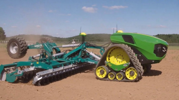

No joke - because it will not be long for them switching to autonomous tracked electric tractors (experimental prototype below). https://www.youtube.com/watch?v=TzRSzu15CLk
A natural for Farmers with leased land for windmills or his own over the cost of fuel. Concept would allow a swarm (multiple tractors fielded at a time). Combines next..... JD has had technology to map & measure soil conditions, seed spacing, yield etc, the fields are already mapped. The antenna devices on top of the prototype are the same devices that have been used in Precision Farming. https://www.deere.com/en/technology-pro ... lsrc=aw.ds
More tech - "See & Spray" targeting and spraying only weeds on fallow ground. https://www.deere.com/en/our-company/ne ... ay-select/

I'm impressed with the electronic autonomous JD tractor above; now if the Deere engineers could just come up with a gas gauge that works for my E-140, I'd be really impressed!
