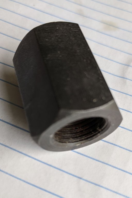

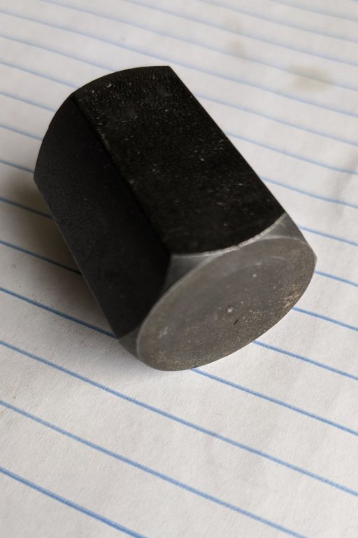

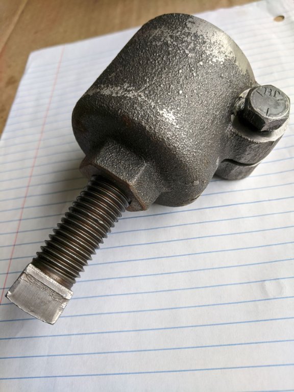

A couple of years ago, I rebuilt my Ruxtell rear axle using new hubs, axles, and keys from Langs. These parts were made to perfection, but fit together so well that now I cannot get the rear wheels off. I tried the screw-on puller in the photo, but it had no effect other than starting to damage the axle threads. No real harm done, but no joy either.

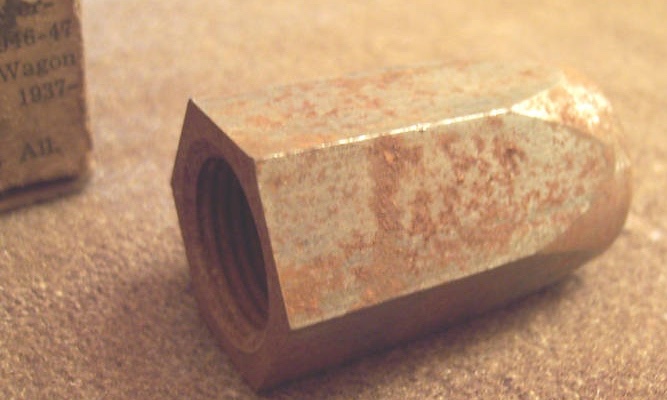

So I bought the “knock off wheel puller” in the other pix, but I am not sure how to use it. I recall reading something about jacking up the wheel you do NOT want to remove, leaving the wheel you want to remove on the ground, removing the axle nut, installing the knock off in its place, and then giving it a good whack with a large hammer.
It seems to me that you are in essence keeping the wheel and hub stationary and moving the rest of the car away from it via hammering on the axle. The last thing I want to do is bugger up my nice fresh rebuild. So my questions are: Is this how this tool is used? If it is, how hard do you whack it? How many times should you whack it before you stop? What components in the rear end take the force of the whack, and can they be damaged? I’m thinking thrust washers, gears, Ruxstell parts? And if I am mistaken about all this, can someone please give me clear step by step directions on how to use these tools?

RE: knock off
Jack up the opposite wheel.
Keep the wheel you want to remove on the ground.
Hit the knock-off with a large hammer.
This is how it works: the wheel that you want to remove remains stationary while the car/axle moves slightly when you hit the knock-off.

Generally I only have to thread on the puller...tighten the small bolt, tighten the long larger bolt on the end, gove it a rap or two with a hammer...then co ti ue tightening the bolt on the end til the wheel breaks free. Be sure to release the parking brake!

ALWAYS thread the small knockoff nut fully onto the axle threads, until it bottoms out.

You are correct on using the knock off puller. With the wheel you wish to pull set on the ground, You are knocking the rest of the T out of the wheel. The force is stopped at the wheel and not transfered inside the differential. Tighten the puller as tight as possible and hit it with a heavy hammer about two times. Then re tighten the puller and hit again. KEEP THE PULLER TIGHT !!!

Dont use the knock off tool. Easy to damage that axle stub. For tough fits, ese the screw on puller(1st pix).
Loosen the nut one revolution. Put the puller on & tighten the square head bolt. Real tight. Drive the car, a few right & left turns. Should release.

Knock Off, used correctly won't harm the axle threaded end. Only if the Knock Off is bad or you don't thread it til it bottoms out on the axle end. The Knock Off threads are deep.

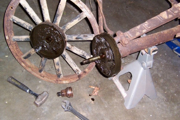

Wheel puller instructions - Copy.jpg (120.27 KiB) Viewed 4356 times
Or if you have the hub thread 'puller' tool, that works similar. Thread on the tool fully, then seat the bolt end against the axle shaft. Tighten fully with large wrench. Then whack on the large bolt head to 'shock' the axle back some from the wheel hub taper. Sometimes tightening again the tool or the bolt for stubborn axle to hub interface.

Loosening the axle nut, reversing it and threading it on backwards such that it protects the threads of the axle, then putting on the wheel puller TIGHTLY, and going for a short drive may be the only way in the world to get those two particular parts apart.
