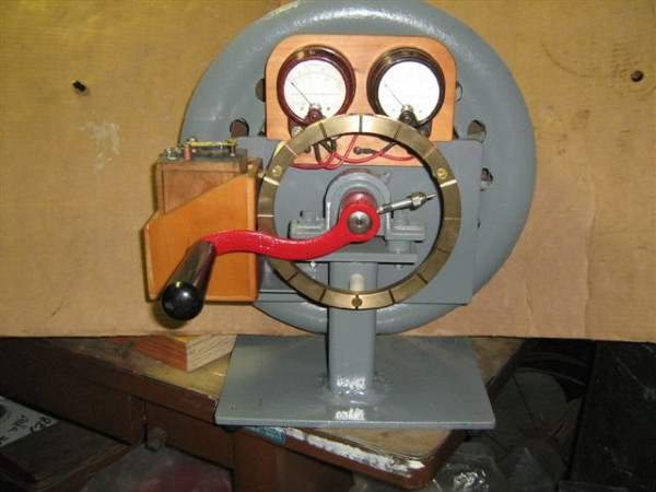

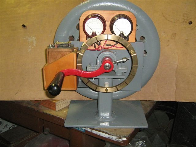

Tim, If they start lining up to much at Mike's send them over to me. I have that home built one that I made. Jim

There is NO comparison between a HCCT & the ECCT tester in the quality & accuracy. I have used my restored hand cranker for many years. I took my adjusted coils & tested with the ECCT. I was supprised by what the hand cranker didnt show & the needed readjustments. Fortunately, I have access to an ECCT, thru a fellow hobbyist. I use my hand cranker for initial settings only.

I got lucky when years back a local fellow T’r contacted me through the Forum after a post similar to yours. I had already redid a set of coils and was a buzz box guy. Couldn’t believe the change a set of HCCT’d coils made in the car’s performance. No experience with the electronic units but I suppose they are OK too. As to rebuilding coils: very doable. I pop off the small side of the case where the capacitor is and go to town chipping away. Usually leave the glass insulator in place. Solder in the new cap use some wood scraps to fill the space and heat the same tar that came out in a can on the barbecue. Man does it stink. Outside only. I’ve done about 12 or so over the years usually for my own use. Haven’t had the need to buy any tar either but I do it on a tarp and reclaim everything. I never check the old caps I just replace them. Order your caps & points Before you start work. I could go on. As to the HCCT or whatever: I would really try to find someone nearby that has one before spending any $. Big investment.
