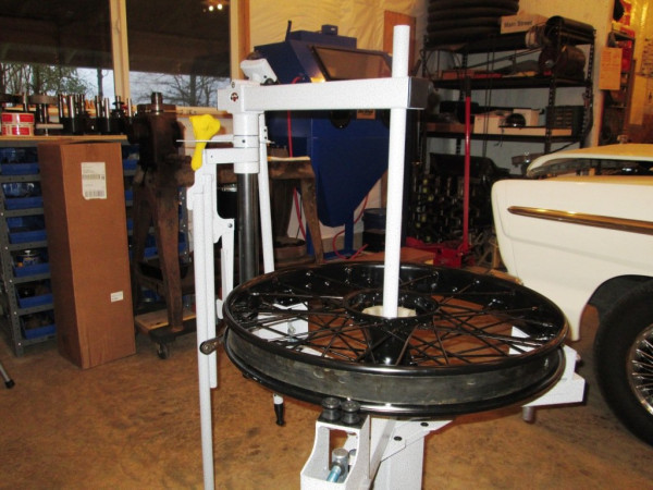

- Posts: 5602
Re: Wood felloe wheel - assesment
Considering I've mounted 29 clincher tires, mostly Firestones, just in the last 2 years, I'm not new to tire mounting - I take care of several of the local T club's tire mounting needs. I just yesterday removed a Lester 30 x 3 that was mounted over 50 years ago and it had a flap & I even re-used the tube & installed a new flap - went on my '14 Touring that is doing the National Tour next month. We can surely agree to disagree about this subject but if you want me to mount your clinchers, they're going to have flaps !
