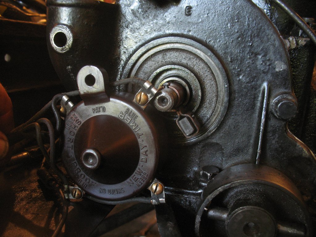

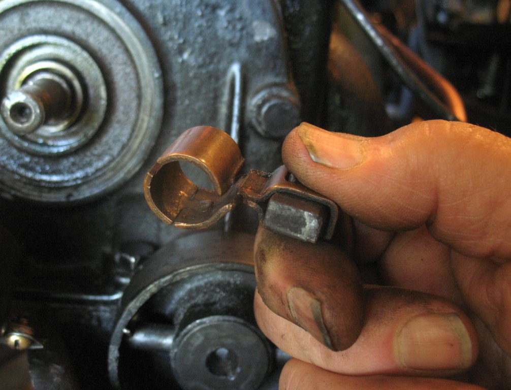

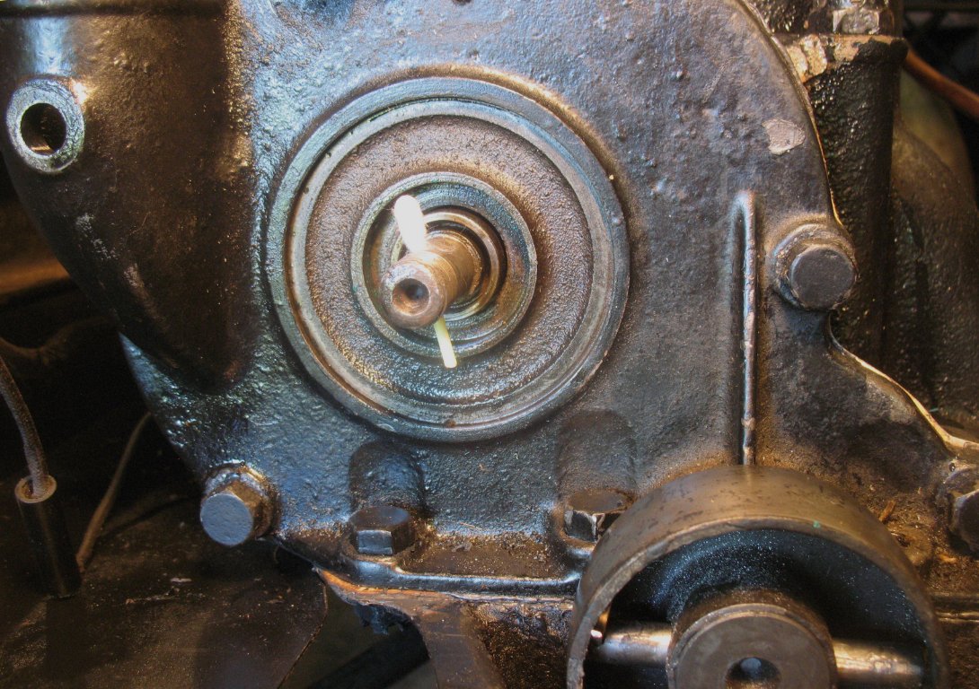

You haven't got one of those earlier cams where the pin hole for the timer rotor goes all the way through, do you? If you're like me, the 50/50 chance of picking the correct hole means I'm 100% certain of getting it wrong...
- Posts: 3743
- Last Name: Wrenn
Re: Feeling stupid
Jerry!! You took the words right outa my keyboard! I'm voting for wrong timer pin placement.
Otherwise, timing is just too "far off".

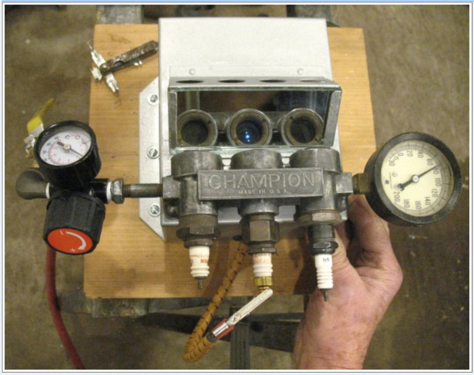

Laying spark plugs on the head and watching each of them spark in correct order only checks the firing order and DOES NOT prove that there is enough coil current to fire the plug since the plug in that arrangement is not under compression. You later said you saw a "blue" spark" when the plug was tested with compression. Was that a test of the plug alone and off the car? A typical T spark plug gapped at 1/32" has the equal of about 1/8" (gap x compression ratio) when inside the engine and under compression. Quick test is to setup a 1/4" gap outside the motor using a block of wood and a coat hanger gap testing device. Then make sure that the spark jumps that 1/4" gap which is about twice as strong as it absolutely has to be but should be easy for any good coil. Somebody once told me that 90% of all carburetor problems are electrical in nature... It is not clear to me that the ignition voltage is for sure enough voltage since I don't know how the spark plug "blue arc" was performed. The spark plugs laying on the motor has fooled a lot of people including me. That test only proves out timing but not that there is a healthy spark inside the motor.
Topic author - Posts: 7395
Re: Feeling stupid
...I'm sure Steve used his neat spark plug tester.
Yes, I did. But that only tests the plugs, not the coils. I guess I should check those too.

A simple screw driver with a buzzing coil, spark plug top to head on each cylinder would do it.
Is that any different than laying the plugs out on top of the engine and watching them spark?

I started with compression testing, first dry then with six squirts of oil in each cylinder.
1 24 24
2 33 30 I have no clue why it would be lower wet.
3 0?* 36
4 30 34
*Zero? On the compression stroke the needle jumped up over 30 and immediately fell back to nothing.
I must say I have my doubts about the accuracy of my tester. Going by the difference in feeling when I crank with plugs out and plugs in, I think it may be reading low.

When I set about checking the timer I found this. I doubt that it has anything to do with non-starting, but I'll have to get the radiator out of the way and deal with it.
1 24 24
3 0?* 36
4 30 34

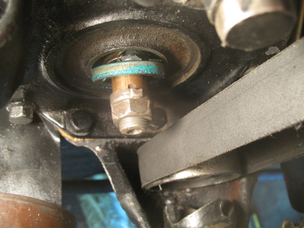

Certainly, fix the loose cam seal, check the position of the timer rotor (verify not 180 degrees out), and try again.

Well. See what I found.
The 180º guys nailed it. I was sure the cam was a later one, but I was sure wrong.
The brush is pointed to green (#4), not black (#1).
But wait, there's more. The broken brush flops around on the shaft like a wet noodle.
I also found that the timer control arm wobbles on the rod. I have more to do here than just replace a cam seal.

I'm back, after a bit of a detour. My timer control lever was loose and floppy from wallowed out holes in the lever and rod, and the pin was a cut-off nail. So I took a couple of days to find and paint a better lever, pull back the steering column to fill and redrill the hole in the rod, install the lever with a new pin, and reinstall the steering. Then I got back to attempting a start.
I replaced the broken timer rotor with a new one, installed it pointing to #1 (red) with the timing set at 15º past TDC. Looking through the #1 spark plug hole, I observed that as the piston came up after the power stroke the exhaust valve opened. I assumed that if the #1 valves are right, the rest have to be also. I set the carb adjustment at 1½ turns, set the throttle lever down at what looked like about 20 mph, pulled four times on choke, buzzed the coils, and gave it a go. Nothing. Dead, dead, dead. Not even a cough.
I unscrewed all the plugs, dribbled some gas in each cylinder, replaced the plugs, flipped the switch to BAT, and tried again. Nothing.
I'm grasping at straws now. I'm sure the Splitdorf plugs are good. They look great in the tester. But I replaced them anyway with Autolite 3095's that also tested good. Nothing, of course.
So that's where things stand now. The next thing I'll do is go back and study all the posts above and see if there's something I missed. After that, I don't know.

Re: Feeling stupid - hard starting
I’m a bit lost. Concerning why you said the brush was pointing at 4 instead of 1. What was wrong there? The thing ran like that didn’t it? Or am I mistaken about that too? I sure as hell hate this long distance diagnostics. It just doesn’t work. Every time you look at this thing you seem to find something else. If (yet once again) you’re sure everything is 100% I’d be thinking about a tow.

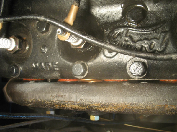

What gaskets are you using on the manifolds?
Stock steel rings with copper crush gaskets, with hi-temp RTV added to assure a good seal. The thought of a leaking intake manifold did occur to me, but what I can see of it sure looks good.
I tried another start this morning. Three chokes and four pulls got it going, but I wouldn't call it smooth running. Pulling the crank is easier than it was before yesterday's running.
- Posts: 2547
- Last Name: Strange
- Location: Hillsboro, MO
- Board Member Since: 2013
If the steel rings are too tall, you won't get enough crush on the copper gaskets for a good seal. I have not had lasting results with high temp RTV on exhaust ports (with my 1971 Plymouth GTX, I never tried it on a Model T).
- Posts: 4694
It's possible that your block or manifold might have been resurfaced on the side of the block. Try the manifolds on with the steel rings without the copper and see how close you can get the manifolds to the block. If they won't pull down, try grinding a bit off the rings.
The block is definitely not resurfaced. That's the reason for the RTV. I doubt very much that the intake manifold has ever been resurfaced either.
Comparing a new and uncrushed copper gasket with the ones in the car, it looks to me like the installed ones are crushed.
This morning the car started with three chokes and three pulls. After choking, turning on the ignition did produce a little jump, sort of an attempted free start. After three pulls got it going I ran it less than a minute and restarted it with no chokes and three pulls. I consider that acceptable, but one pull would be better.
While the car is now reasonably east to start, I'm not satisfied with how it runs, which I would not call smooth at all. I'll keep working on that, and I expect I'll figure it out sooner or later.
