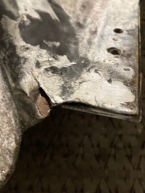

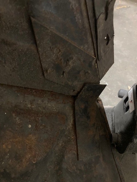

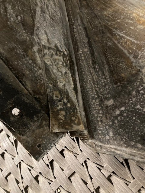

I have 2 used 1914-15 fenders. In preparation for painting one has been paint stripped and wire wheeled to get paint and surface rust off, then Metal Prep phosphoric acid treatment to keep them from flash rusting. That is the white residue seen in the picture. Flash rusting occurs quickly in hot, humid, Houston if you don't coat with something. The fenders are in fair condition but I notice that they both have spot welded patches on the underside where the two pieces of fender meet. One had clearly started to crack and was patched and has a light coat of body filler. The other is slightly cracked but has patches on the under side as well. Should I try to weld the crack shown in the second picture or leave it alone?

The patches are not standard. The fenders may be reproductions, and the problem may be that the flange which bolts down to the frame rail is not bent at the correct angle to the inner skirt. If that fold is not spot on, bolting down the flange will put considerable tension on it, leading to the cracks shown. I would remove the patches completely and mount the fenders in their final position, allowing the crack to open up as they are bolted down. The crack will have relieved the tension when it opens up. I would then weld the crack in its open position while it is not under stress, and the problem will go away.

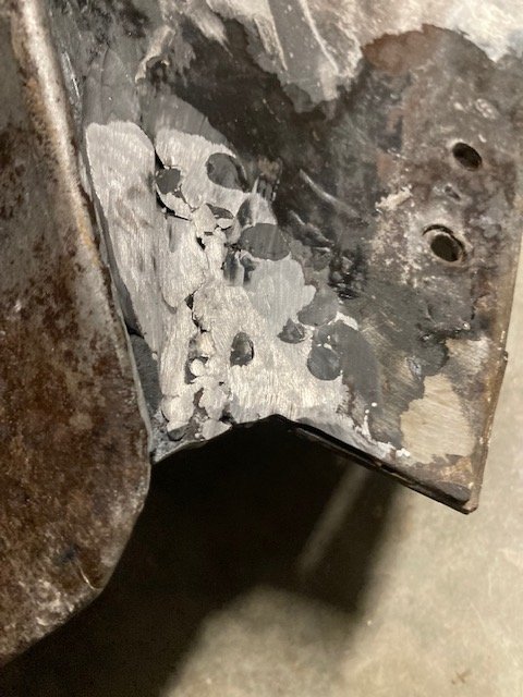

So I left the patches in place and welded the crack but I will take your advice and bend them to the proper angle on installation. I think it turned out ok for someone who doesn't know what I am doing
I have applied Metal Prep phosphoric acid and will skim it over a bit with body filler.
