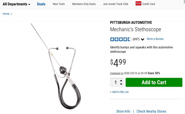

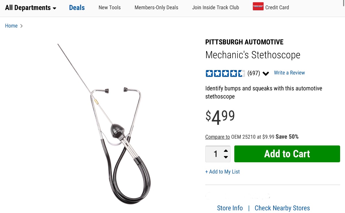

It could be a loose fan belt pulley. It may be a loose rod that needs taking up. Use a mechanics stethoscope to isolate the sound while the engine is running.
ecory0
Posts: 90
Joined: Mon May 03, 2021 7:55 pm
First Name: Eli
Last Name: Cory
Location: Bristow, VA
Re: Does this sound like a knock?
Post by ecory0 » Sat Jun 12, 2021 7:44 pm
Sounds like I’m off to harbor freight to by a stethoscope. Great suggestion. So I’m not crazy about the sound?
