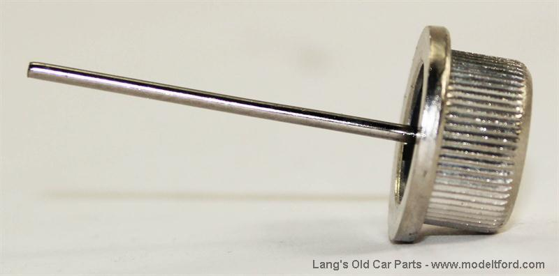

Can we assume that the cutout you had rebuilt was done with a diode and not the old solenoid?
Who rebuilt the cut-out? Externally Model T & A cut-outs look similar BUT T's are negative ground and A's are positive ground - an A will give you a spark.
Is the bottom of the screw that attaches the wire to the ammeter touching the generator housing? Can happen if to long or by bending the connection downward when tightening the screw
Do you know what they set the amperage output of the generator at? Reason the Diode Cut-Out Langs sells says its rated for 5 amps (likely as a safety precaution) and can more but it would be worth knowing in any case.

I rebuilt a cutout with a diode it all checked out okay, even with a diode checker on my ammeter. Insulated everything internally, hooked it up and when the ground strap made contact to the battery it gave a small spark. I will be checking out a second diode I have Tomorrow and will report the findings. I'll be performing the above test on both the problem cutout and the second diode.
