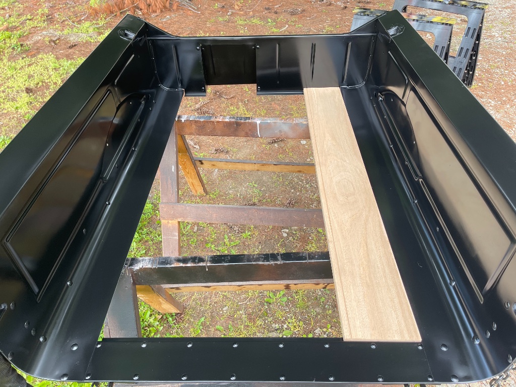

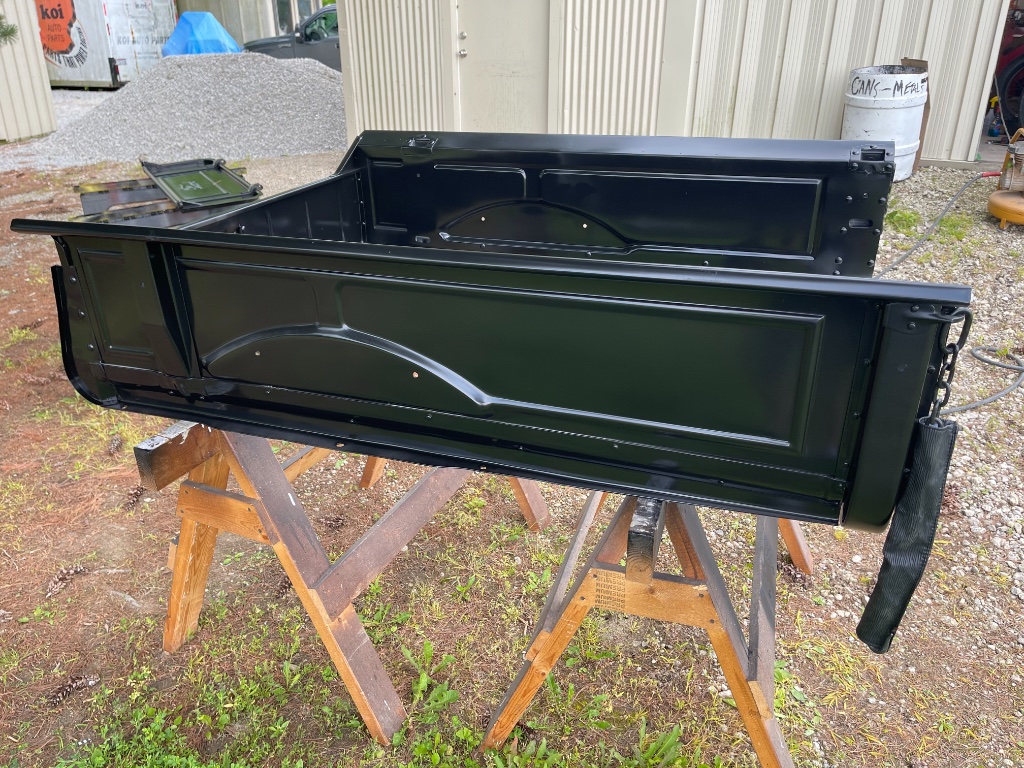

Trying to find a layout of how the wood bed floor is assembled and bolted in. I assume it will be easier while the bed is on saw horses. The wood kit is cut for the battery hatch so what supports the planks that are cut. Is the floor sturdy enough after all is tightened up with the bed strips?

Here’s older post on the late beds. Yes, the metal strips provide full support, the bolts and large square toothed washers under the boards do the job. Note the wood board sketch is mis-marked as for ‘25 early bed, the sketch is only for 26-27 beds.
http://www.mtfca.com/discus/messages/59 ... 1475071675
As far as support for the battery hatch or lid, some runabouts still had the metal floor under the turtle deck, so the hatch fit the same was as when under the turtle, that is it rode on metal flange of the deck. If your runabout has no floor, then add some support to the sides and rear for the hatch lid. The front of the lid will ride on the flange of the body tub. I just used some oak pieces to make supports there.

There are a few things I notice about your bed/wood installation and some other comments from my bed wood installation adventure:
1) the floor wood shown in your photo slides under the bed metal along the edges of the bed. I don't see any holes in your bed lip to accommodate the hold down bolts/flat washers. You can see the bolts along the edge in this photo that I copied from one of the links provided in another response above.

2) the battery access will need to have some wood pieces added to support the battery access lid. You can see what's added in the photo. I only added one at the end of the batter cover access. Your battery access does not appear to have the metal bracket the supports the rear edge of the battery access lid (see photo).

3) I suggest you lay all the boards and hold down strips in the bed to get an idea of how it will all come together and observe the gaps between boards to accommodate the hold down bolts. Put the battery cover in to make sure it will fit properly. On my bed, the crossmember panel did not center over the crossmember. I confirmed with others that this is just the way it is.
4) the boards in my "kit" were a little thick and did not slide under the bed metal. I routed a little off the bottom of each board on the end to allow it to drop down some and slide under the bed metal. I failed to check that the crossmember cover would fit such that the top of the panel came out flush with the bed boards. If it doesn't there will be a gap between the top of the panel and the hold down strips. I should have routed out the bottom of the surrounding boards to make the panel come out flush. The strips that cross the crossmember cover are riveted to the cover.
5) there are bolts that go thru the holes in the ends of the hold down strips and attach the boards to the z-panel and the lip of the front panel assembly . The holes will have to be drilled when you position the boards/strips properly in the bed.
6) my wood kit was not cut properly and it took some work and modifications to make it all come together. The cuts for the battery access and crossmember cover were not positioned correctly. If you look closely at my battery lid opening, you will see the "filler" pieces I had to add.
Unfortunately, I purchased the wood kit several years ago off the classifieds and don't remember who I got it from nor who might have been the original producer. That's why I suggest you put all the pieces in the bed and make sure it all comes together properly. If the boards are to long, put some thought into which end to cut off or you will impact the battery access and crossmember panel opening location.
7) the edges of the bed strips I purchased were flared out on one end or some reason. I had to trim out some of the floor board wood strip channel to accommodate the flare. Easy to do with a blade knife. I put the flared end at the rear of the bed. If yours are not flared, you can forget this comment.

I like the yellow pine idea better for none other than it is half the weight of oak. This metal bed is heavy with the oak boards. Making the floorboards is not an issue as we have a sawmill and full cabinet shop. southern yellow pine is not my regional wood though, I am in southern Ohio.
So these last comments told me this bed has to be a reproduction? It is in too good a shape to be original and it doesn't have the holes drilled for the boards to mount. This is fine by me, but I didnt think these were reproduced. It has been stored a good while.

Re: Pickup bed wood floor question
Post by Duckwing » Mon Jun 14, 2021 11:13 pm
To my knowledge no one has reproduced a pickup bed. It is in amazing condition. Maybe someone else knows of a reproduction bed.
