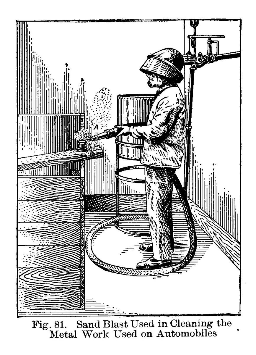

I came across this picture the other day. It doesn't help answer your question but it does look pretty cool.
