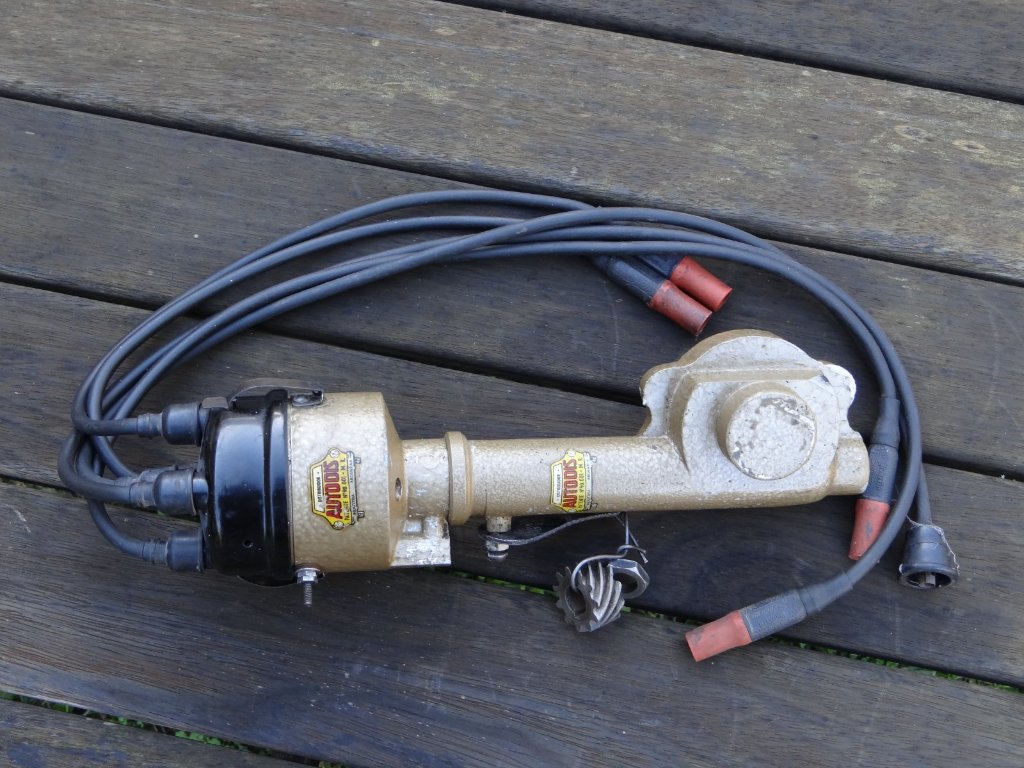

Watch for an Auto-Dis distributor. These were made in Argentina in the 60's and are Bullitt proof. Very easy to remove the auto advance and make manual. I have been running one for over 50 years and the bushings are still as tight as new. Uses Autolite points cap and rotor.
