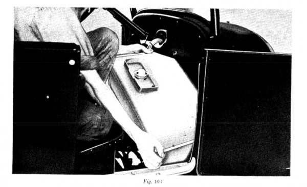

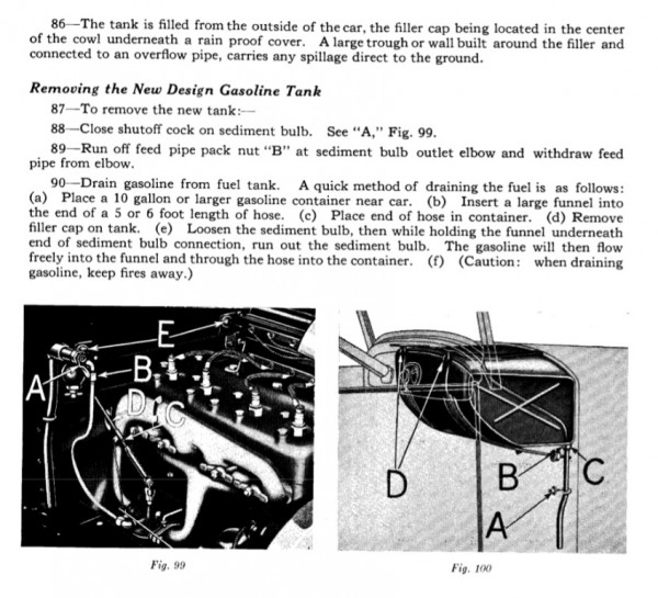

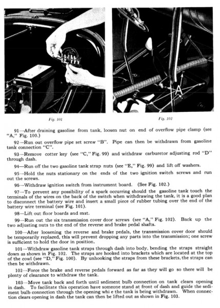

You shouldn’t have to remove or loosen the dash. You do have to remove the floorboards. The info on procedure is in the service bulletins.

Adam
Posts: 1550
First Name: Adam
Last Name: Doleshal
Location: Wisconsin
Re: Removing a gas tank from a 26-7 roadster
Post by Adam » Thu Jun 17, 2021 9:10 pm
Adam
Posts: 1550
First Name: Adam
Last Name: Doleshal
Location: Wisconsin
Post by Adam » Thu Jun 17, 2021 9:23 pm
GG Gregory wrote:
Thu Jun 17, 2021 5:25 am
Adam wrote:
Wed Jun 16, 2021 9:44 pm
Adam, you DO have to remove the dash panel on a 27 Roadster …been there done that.
Nope, just have to follow procedures (posted above). Done it probably four times. YES, there is no margin for error and it can be a real pain to get everything in proper alignment, but it can be done.
The coupes and tudors are super easy. The tourings and roadsters are much more difficult, but once you’ve done a couple of them, they aren’t impossible.
