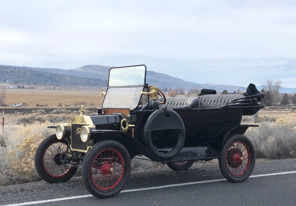

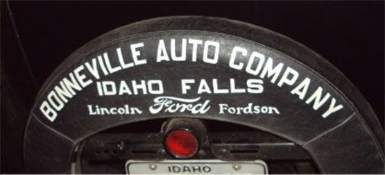

I have in mind doing something just like this. My tire cover has a top half that would be great for graphics. How did you paint yours? Was it traced out with pencil then freehand painted? What paint will work without chipping off as the cover flexes in the howling 35 mph breeze?Rich Eagle wrote: ↑Wed Jun 16, 2021 3:25 pmI see Eckler's has 450 X 21 "no Logo" one's but I don't see any 30 X 3 1/2 any where. You might call one of the T part's dealers to see if they have any suggestions. I made some using an original for a pattern. There are several styles.

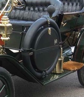

I found this picture on a Swedish website of a 1910 Model T. Now the spare looks like an inflated inner tube. Thoughts?
What I really like is the centre carrier. To me it's a wonderful looking accessory.

John, that spare is most likely an unworn treadless tyre as available in the early days. They do look most odd. The insert is most likely a container for a collection of spares/tools/whatever.

You are so right! That's exactly what it is...thanks Allan.
I really think the container is not only useful for extra storage but great looking.

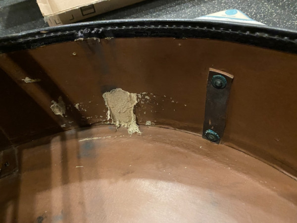

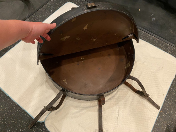

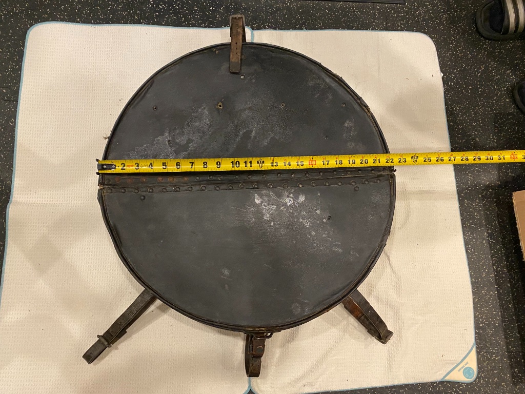

The round item inside the inner tube is a piece of luggage.
I have one but not in such nice condition as the one you posted a picture of.
The diameter of the round luggage is approx 22" with a depth of approx. 6.5".
The straps are leather but I am u sure about material of the luggage itself. It seems like it has base structure that was coated with mesh with some type of a solidifying blacksubstance. It was suggested that I try saddle soap on it which helped a little bit but I would like to restore this item. If anyone has any suggestions, please advise.

I sewed my cover from black cotton twill and then gave it a few coats of black paint.

Janet:
Use mild soap and water to clean the exterior of the trunk. Dish soap or Murphy's Oil Soap will suffice.
After it is thoroughly dry, apply some black Kiwi paste shoe polish and then buff with a horsehair shoe brush.
My dad had one of those spare tire trunks about 50 years ago - it was in excellent condition. He sold it to another antique collector who lives in the neighborhood and I'll bet it is still sitting in his garage.

Re: Tire Cover
Erik
Thank you for the suggestion. I will try that.
Janet
