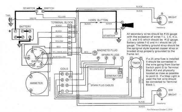

The closer you put the fuse (25 amp) to the power source (starter switch) the better. With the floor boards out not to difficult. A search of the forum should give your the routing diagram and Ron Patterson's schematic will help.

I've also noticed wiring diagrams from well known sources, that are not accurate.
Is Ron's diagram wrong?, If so, how?

I have replace wiring harness. Just get them from a good source. IE from the guys on the resources page.
Use the diagram shown above.
you will be all set.

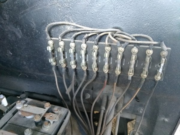

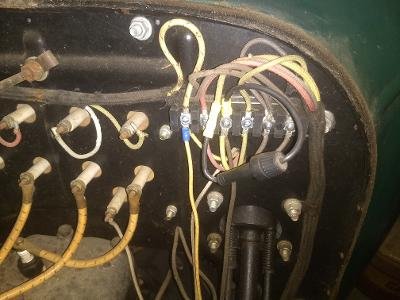

Take pictures as you disassemble the wiring so you can see where/how the wiring was attached at different points. It helps to include a small numbered cue card in the photo and record a note or two about that numbered photo (where it is, wire color etc). This diagram should give you some idea of what / where things are attached. It would help to understand what the cause of the electrical issue was to ensure it was properly remedied.
Included some pictures of the wiring block - don't remember it you had a starter or not. I assumed that your T is the one specified in your profile 1922 Ford model t touring
