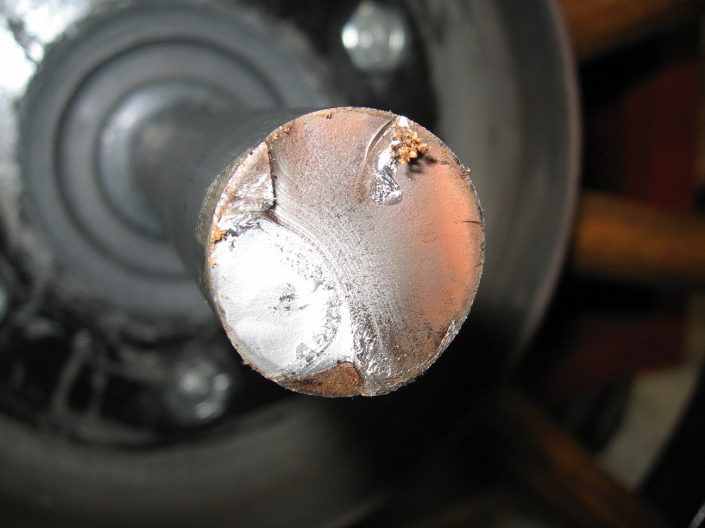

Re: Need some help
I had the same symptoms. It was a broken axle. happened as I put the pedal down to cross an intersection. Click! No progress.

Re: Need some help
Same here, broken axle shaft. Started off from a stop and heard a pop! The engine ran, but the car wouldn't move in any gear. I called a flatbed and got a tow home. Gave me a good excuse to install the Ruckstell rear axle that I had built.

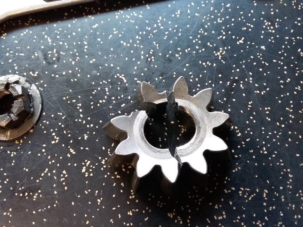

kelly mt
- Posts: 276
- Last Name: Kelly
- Location: Noxon MT
Re: Need some help
This had the same symptom, broken pinion gear.

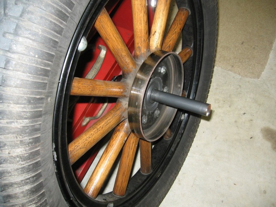

Re: Need some help
Put the rear end up on jack stands. Diagnostics. Both sides, pull wheels outward. If they dont come out, rotate. Opposite wheel should rotate backwards. If so, axles/ diff are ok. Could be sheared ring gear bolts or the more common pinion gear key sheared. You can look in the diff. fill hole with it running in gear for ring gear movement or not. If you have gotten this far. Now its the pinion gear or drive shaft.

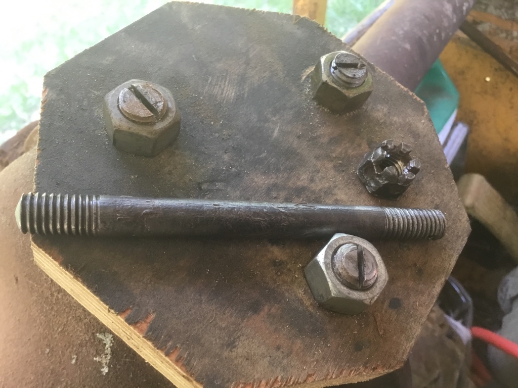

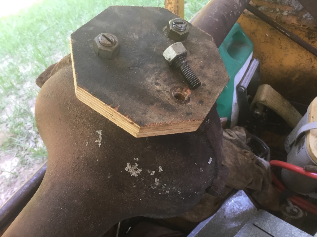

Here is a heads up. That wonderful Norm Kling in Alpine, CA helped me replace my rear axels and, among many other lessons that weekend, I learned something the hard way.
Here it is; When breaking down a Model T rear end the first thing you might want to do, after removing the rear end from the car, is go around the housing and torque all 6 of those bolts/ studs. I recommend this because you don't want to find out that one of those is stripped "after" you have reassembled your fresh rear end. Typically, you would have to take it completely apart again to correct this problem. So, a minute spent checking can potentially save you a day's work.

- Posts: 5277
Re: Need some help
Are you talking about the 6 DRIVE SHAFT bolts/studs?NorthSouth wrote: ↑Fri Jun 18, 2021 11:27 am-
John,
During a proper rebuild those 6 holes should be inspected & threads chased. Along with removing/cleaning the old grease & dirt. Maybe you find that housing crack. As in a motor overhaul, address all threads

- Posts: 4694
Re: Need some help
could be anything from the transmission output shaft to the rear wheels. Most often would be the driveshaft, or the rear axle. Next would be the gears in rear axle. Easiest to find would be a broken axle. Unless you have safety hubs, a broken axle would pull right out if you jack up the car.
- Posts: 5566
Re: Need some help
DO NOT CHASE THOSE BOLTS UNLESS YOU HAVE THE CORRECT TAP

- Posts: 5277
Re: Need some help
If the axle broke beyond the outer machined race area, it probably would not pull completely out untill the bearing is removed.Norman Kling wrote: ↑Fri Jun 18, 2021 4:11 pmcould be anything from the transmission output shaft to the rear wheels. Most often would be the driveshaft, or the rear axle. Next would be the gears in rear axle. Easiest to find would be a broken axle. Unless you have safety hubs, a broken axle would pull right out if you jack up the car.
The axle would still pull out far enough to confirm a break or departure from the drive gear.

Re: Need some help
Mark is dead-on, the studs are 7/16 X 16 not a common tap or die. .4375 X 14 threads per inch is standard.
- Posts: 5277
Re: Need some help
That is not correct. Measure them again. The correct thread is 13/32-16 .406 dia.
- Posts: 6819
Re: Need some help
none of the above
13/32" x 16 thread is what was done at the factory.
Anything else is a bastardization of the correct diameter and pitch
And there is now proof that John K types faster than I.

I had a similar situation, pulled into the driveway. Opened the garage door and no drive……
I jacked up the rear end and I could turn both wheels and the other would rotate in the opposite direction. I looked inside the transmission and the clutch plate was turning with the crank. So I deduced it was either the UJ or broken pinion gear.
Out came the axle but everything was lust fine.
How could that be possible?????
I poking around I removed the fourth main bearing and the shaft from the clutch was loose??
I pulled the motor and found the problem.
The rivets holding the drive shaft from the clutch plate to the UJ had all pulled out
In my simple mind it’s a real defect with the design in that the rivets are not formed on the clutch side, they are just pressed in and sure enough mine just pulled out. I fixed it by countersinking the front of the clutch plate and spread the rivets while nice and hot.
I know Ford built at least 15,007,033 transmissions but mine failed due to a what I consider a design defect.
I really not sure how to diagnose this failure without pulling it all apart.
