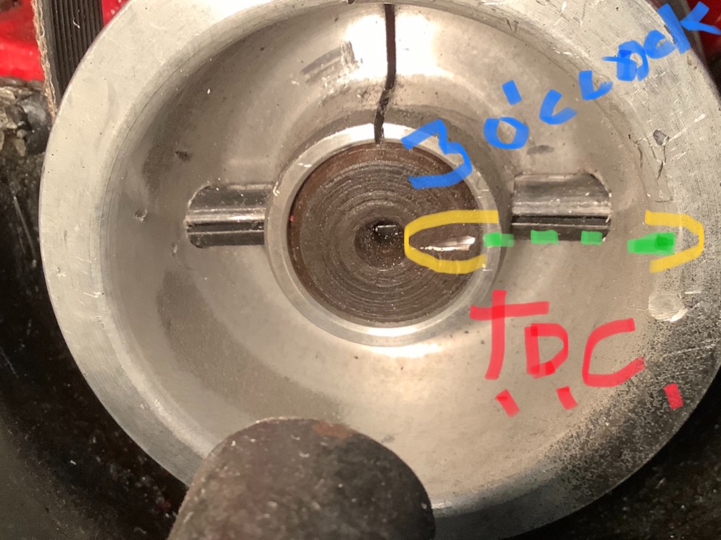

As stated above, the crank pin is horizontal at TDC. Of course, of those two choices , only one is correct. 3 O’clock ! When you find it, a simple mark like this will help you the rest of its life. Just reach in with a fingernail and you have it. I mark all my engines when Joe Bell gets done with them. Never use a paper or plastic straw again, no need to pull plugs. Think ahead and save time in the future.

Hi Tim, I like your tips either. If I understand your picture, the Mark you made is for your Top dead center and it is not at 9 & 3 but at 8 & 2. One of my T, the TDC is not exactly at 9 & 3 either... If I look deeper , I may see bellow another mark of TDC at 15 degree as well so it will accordingly with 9&3 for TDC and 10 to 4 at TDC 14 degree as well. The firts impression It may cause because the picture is a bit on left and now I have my glass, Ha Ha Ha

KISS ! I think my tip came from tinkering tips, by Ted Aschman. Great stuff in his books. Mario, I changed my picture, to show the crank pin horizontal and as you are facing the motor, mark the driver side at 3 O’Clock. That’s TDC You may have trouble finding a straw but you should always have about one good fingernail hanging around. . Check it in the dark, blindfolded, in a rainstorm, no pulling plugs, no searching for straws. Save the environment, make your wifey and friends proud!

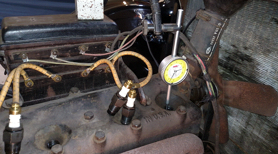

I made an offset extension for a dial indicator and placed it against the #1 piston.
I turn the crank until the dial stops moving and record that reading. This is with #1 on the compression stroke. That is not TDC but close. To set the timing to the correct retard angle, continue turning the crank until the dial drops .087" for 15 degrees retard or .093" for 15.5 degrees, whichever you're are using. These readings only work with stock stroke and connecting rod lengths.
To find TDC you can rotate the crank to any convenient reading, such as .100" ATDC. Make a mark on the crank pully that aligns with a mark on the block. (I used a bent wire as a temporary pointer.) Continue turning the crank until the dial reaches the same .100" reading BTDC. Make another mark aligning with the block. True TDC will be at a point between these two marks.

Thank you Tim, I like the Mark idea, I will add this idea on my own process.Dropacent wrote: ↑Mon Jun 21, 2021 9:27 pmKISS ! I think my tip came from tinkering tips, by Ted Aschman. Great stuff in his books. Mario, I changed my picture, to show the crank pin horizontal and as you are facing the motor, mark the driver side at 3 O’Clock. That’s TDC You may have trouble finding a straw but you should always have about one good fingernail hanging around. . Check it in the dark, blindfolded, in a rainstorm, no pulling plugs, no searching for straws. Save the environment, make your wifey and friends proud!

Thank you Mark posting your method, it's look probably more accurate than mine. I will compare with my straw if I'm close to you either. I have to set my timing for my 1914 this week-end. I will start to sell eco straw soon made in Canada. Ha Ha Ha
