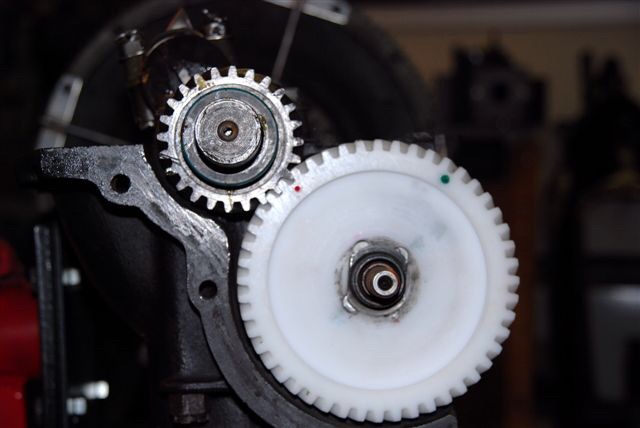

There are also nylon timing gears too that had issues.

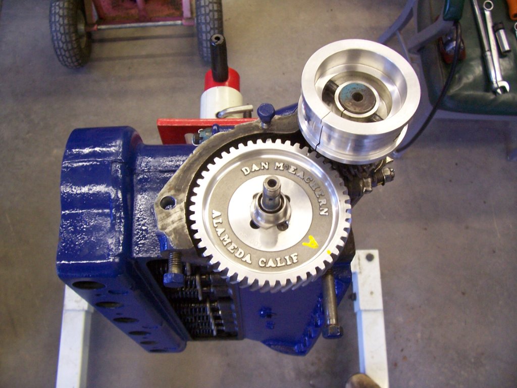

When you do install the new timing gear, be sure to check the clearance to the generator gear. I had to add an extra gasket to the generator mount to get the spacing correct.

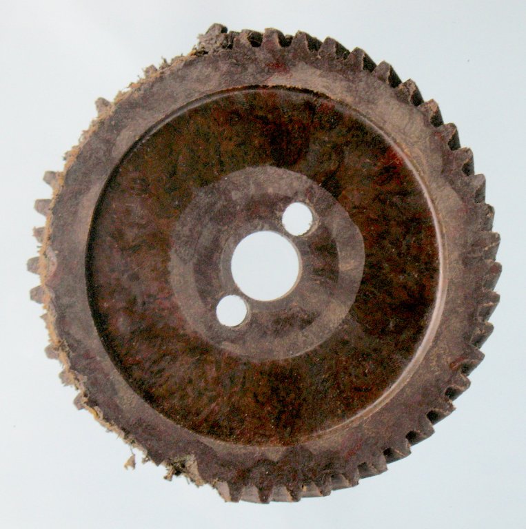

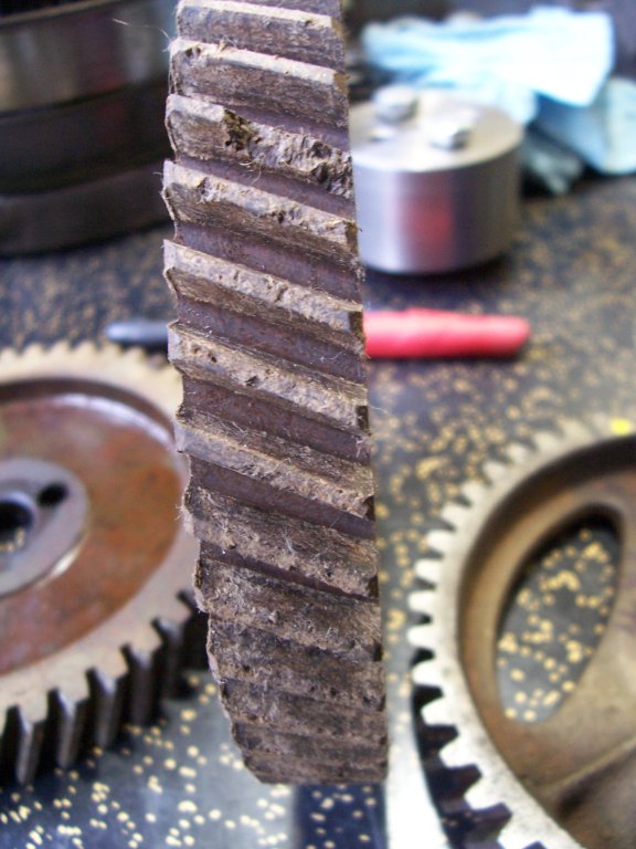

Macerated gears are made up from short chopped up fiber with binder added and compressed to make the gear. Laminated are made out of layers of fabric that binder is added and compressed to make gear. I don't know if all Model A's used the Laminated gears from the factory or not, I think they did, and if so, at some point both the T's and A's have had lower cost macerated gears installed. Both T and A can suffer the same fate, stripped teeth(macerated). While the condition of the generator gear and crank gear in the Model T along with spacing of the generator gear to cam gear may come into play, that would not explain why when the macerated gear is used in the Model A, it suffers the same fate at some point.Allan wrote: ↑Sat Jun 19, 2021 8:19 amThere are/were two types of fibre gears. Tony's, being as old as it is, is likely to be a laminated fibre gear. These are far superior to the stuff available today, these being made from macerated fibre, ie. chopped fibre glued together in some kind of mix. They are like chalk and cheese as far as strength/durability goes.
You will note the mottled surface of the stripped gear shown above, that is a pretty good indicator of being a macerated gear. Laminated gears generally have an even colored surface and may show signs of the fabric weave in less compressed areas.
