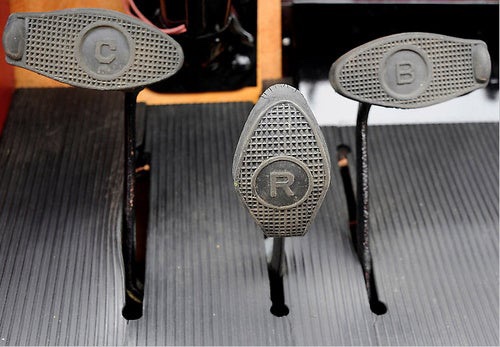

In 1926, Ford addressed the small pedal problem by building pedal extensions onto the outer clutch and brake pedals, but could do nothing about improving access to the center reverse pedal. Being on the outside, I can see where pedal extensions would help on the brake and clutch pedals on pre-1926 T’s, but being in the middle, with only a finite space between the brake and clutch pedals, what sort of pedal extension could be installed on the reverse pedal provide more room for big feet other than bending the brake and clutch pedals outward to increase the space? At 6’ 3” and 230lbs., I have size 14 shoes and must either tilt my foot and use the outer right edge of my shoe or use the point of my shoe to depress the reverse pedal. I don’t go barefoot, ever. Jim Patrick
