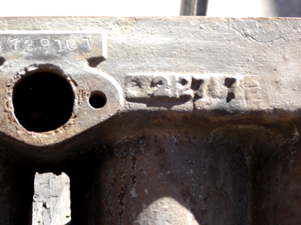

So I listed a 13 engine for sale and put in the ad that it had been restamped-. It was then brought to my attention that the number pad itself was rather large. It infact is. I have a 12-13-14 to reference to and those do have the smaller no.pad. I don't understand how it can have the cast no. On the block and then have the lg.no. pad. Thank you

Did someone remove half of the 3?

My guess is when the number boss was milled away to remove the serial number, then 'somehow' the 8 in the 1918 block loss half of its loops to become that "3".

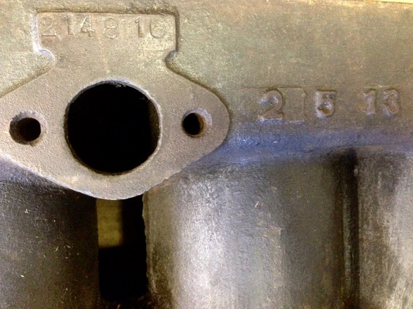

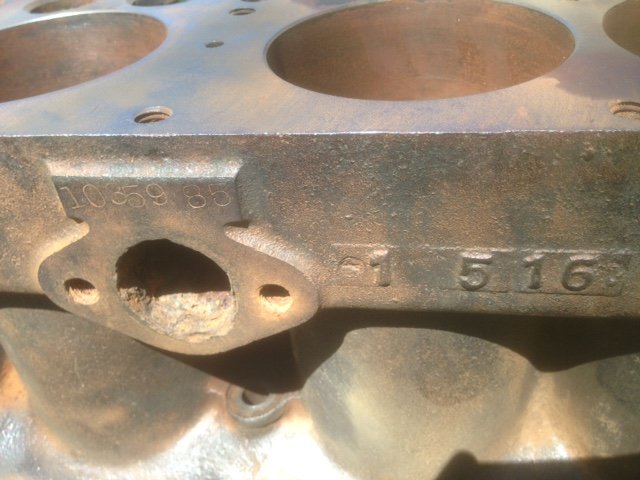

As mentioned above, the engine number boss on the block in question is of a later style, beginning in late 1915 or early 1916. When the serial numbers hit the one million mark the extra digit made for a tight fit for the the guy stamping in the numbers. You can see what an original 1913 number boss looks like and the reason why the boss was lengthened in the 1916 photo.

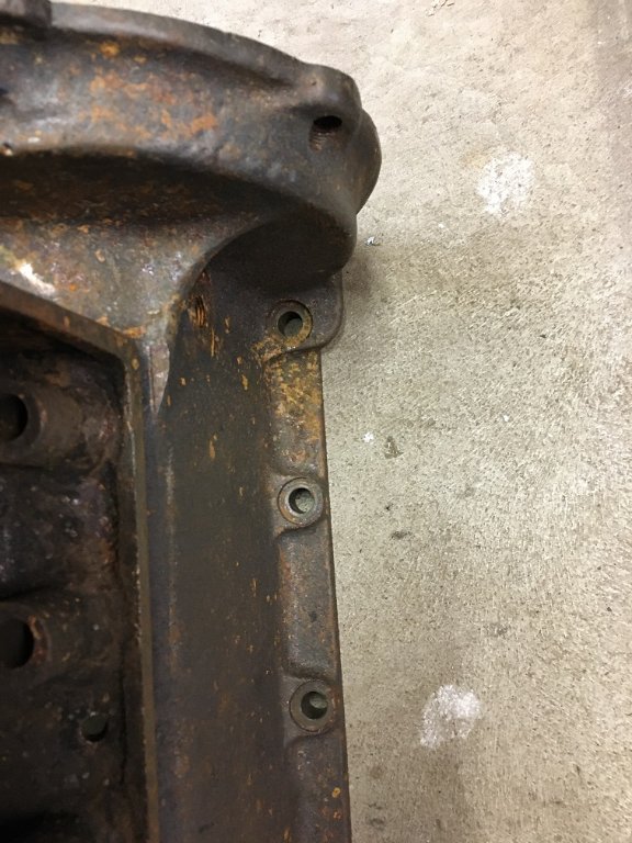

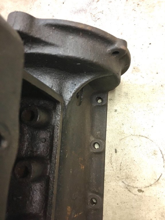

One other change is on the block flange that bolts to the pan - on the right side just back of the front cover. During 1913 the first bolt hole got a reinforcement, which remained there through the end of the non-starter engine production. However in early 1913 blocks this change had not taken place, as pictured below. The non-reinforced bolt hole is from the Feb 1913 block pictured above and the reinforced block is a 1918.

There may be other small changes to the blocks in the 1913 time period that I don't know about. I hope what I've presented helps.
