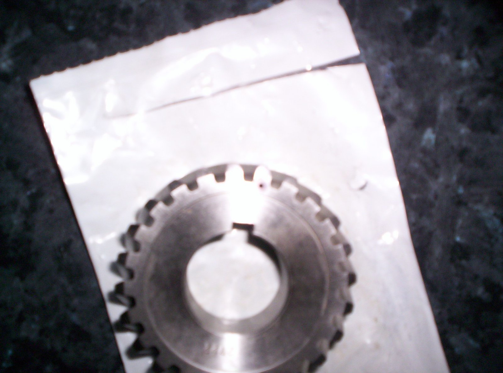

Gary,
the marks line up just off TD centre.

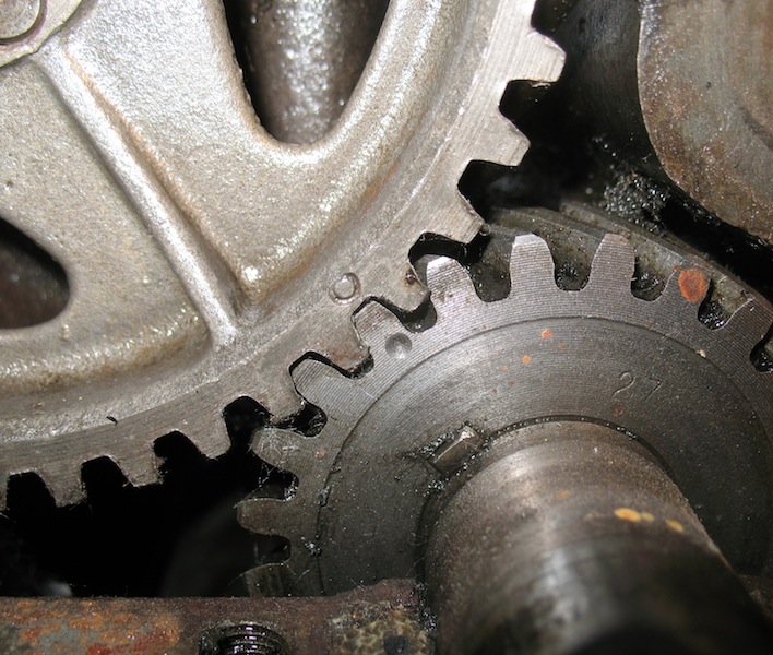

Post by Steve Jelf » Tue Mar 19, 2019 9:38 am
First tooth to the right of the key way.

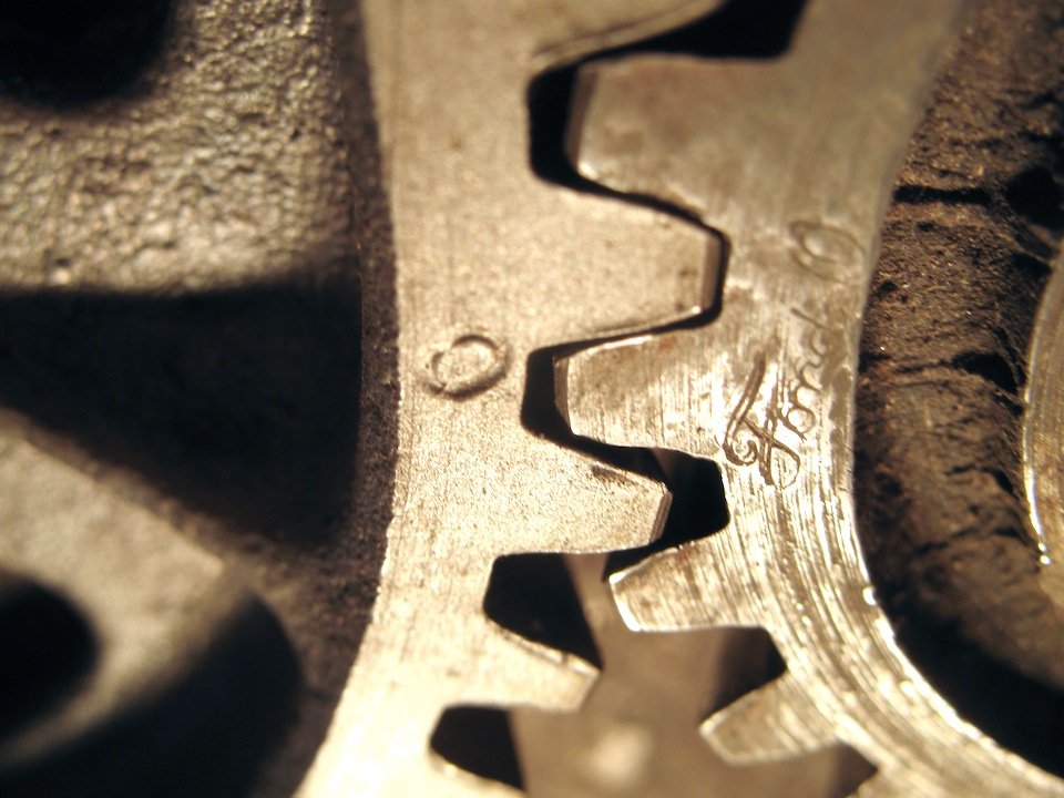

Sometimes the mark is the Ford logo.

Post by Papabear2121 » Tue Mar 19, 2019 9:43 am
Thanks Kerri the Ford shot helped a lot. I found the logo after some work but was looking for the pin prick. Thanks again and back to the garage.
