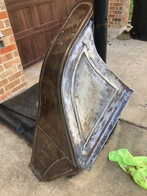

So the front fenders are stripped and sanded for Hay Wagon to Speedster project. I noticed a small crack at one of the front fender hanger mount bolts. Should I drill the ends, weld it shut, and grind off the excess, or leave it alone, or...?
The beak straightening went well. I think I can do the rest with a light skim coat of filler. However, the top flat nose was bent down. I bent it up but the rear part near the crease is hard to get to with a hammer to straighten it out. Is that what the pick end of a body hammer is for?
Other than that things are coming along. I splurged on a Dewalt DWE6401DS sander. It worked well but you go through expensive sand paper disks quick especially when doing edges. I tried a Dewalt corded random orbit sander that was $20 less than the DWE6401DS but it was too weak for the job.

If you leave it alone, the crack will get longer. the only way to make that repair look nice would be to remove the rivet, weld & metal finish the crack repair, then re install the rivet.
