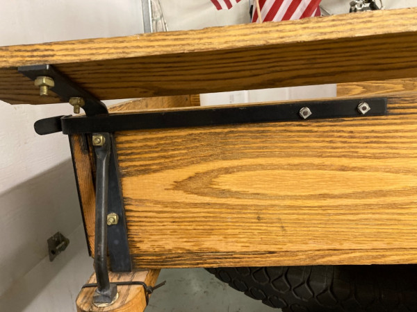

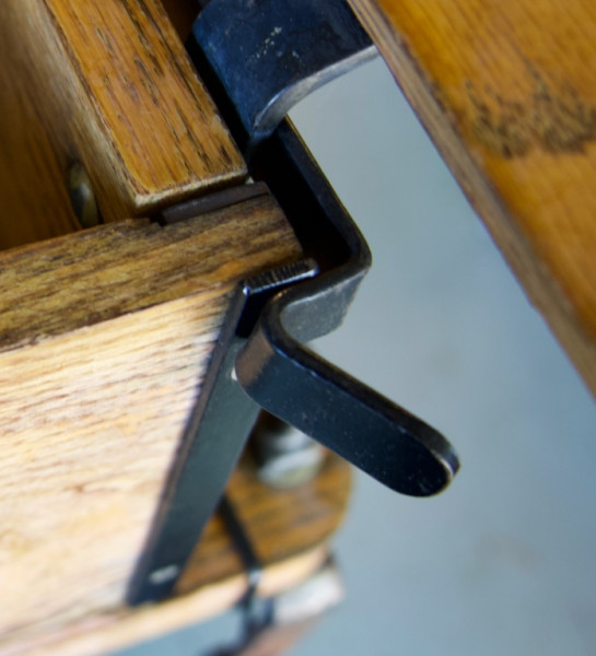

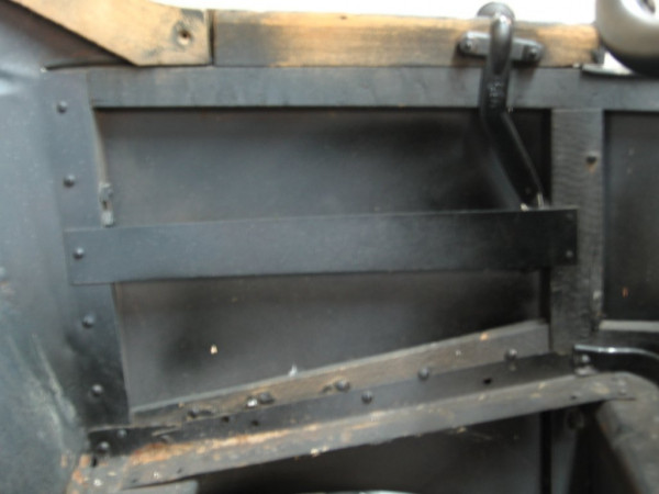

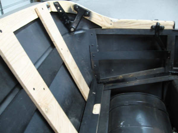

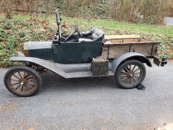

Here's how we did it on the farm:

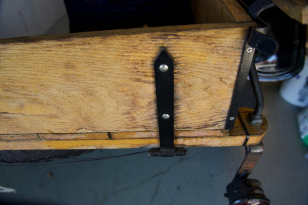

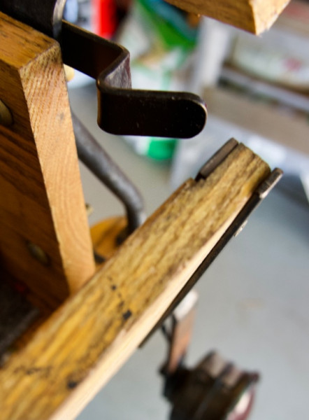

Last one. I made my box out of Oak about 10 years ago so it's not as pretty.

Dean, Just a 1/16 X 3/4 x 15ish strap from Ace. That is enourg "spring" for the aplication

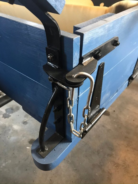

Well I'm committed now, one done , sand and paint another six or so times and it should be O.K.
HalSched, spring steel or spring, looks good.
Bravo on painting your workmanship! Few take the plunge, but IMHO, it looks so much better painted! Nice work.

Thank You.
It just looked wrong in the raw wood , I'm 99% sure it would have been painted back when. You have to match that green and give your cut down some fresh paint (on back that is)

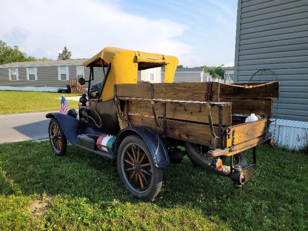

Haha, thanks! We would have, but had some weathered Hemlock around and so went the 'patina' look but took care to use vintage fasteners and hand forged parts. Like yours, really tried to look the part. Fresh paint would make the rest of the car look too shabby! Haha. These cars are too much fun!

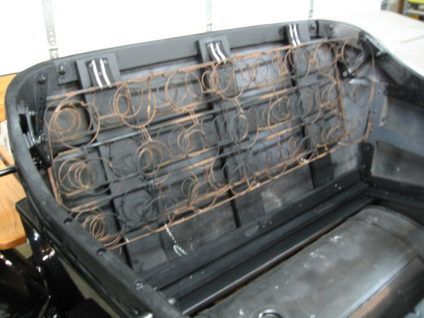

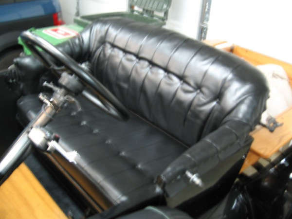

My Henrietta cut down tourer buckboard has the top made from the bows of the original. It no longer folds, so that made the modifications much easier to achieve. You just need to set the intermediate bow at the right height and set-back, and fix it in place in a manner that suits you.

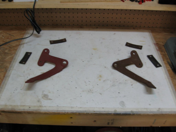

Here is what I did to install a one-man roadster top onto my cut-off touring / pickup. The process might be slightly different for an earlier two-man top.
I found a set of one-man roadster irons and rear brackets online, then bought new top sockets and bows from Lang's. I bought the top kit from Classtique. The seat back upholstery hadn't been installed yet, so I had clear access to the inside of the tub.
The angle of the ears on the rear brackets didn't match the tub, so I had to cut off one ear and fabricate a new ear from some strapping material for the bracket to fit properly. I also had to add shims to the remaining bracket ear to get the angle of the pivot irons right as they came through the body.
The scariest part was cutting the holes in the body for the top pivot irons to poke through. I used a long rod between the rear brackets to locate where to drill the pilot holes in the body, then finished with a hole saw.
