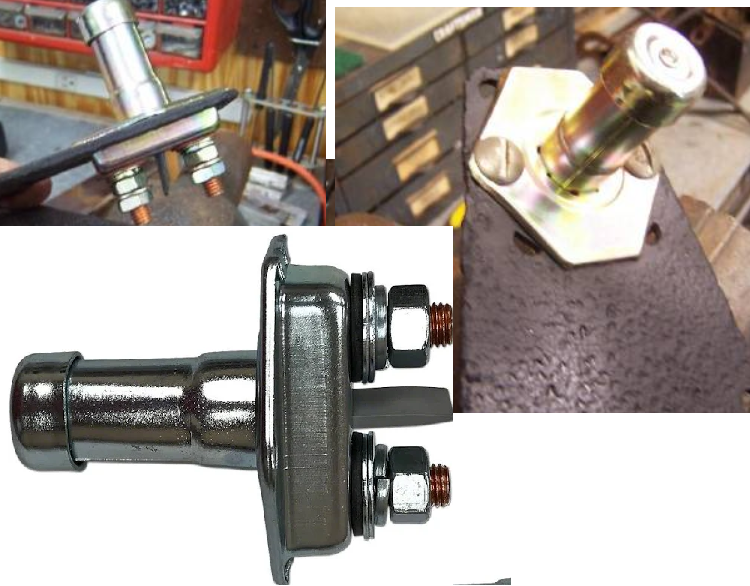

Not sure if you have a switch like the ones pictured below. If its different a picture would help. But like all the others the insulation method would be the same

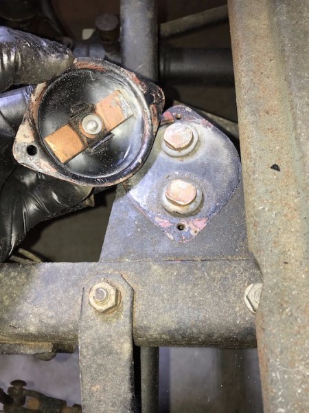

So this is the type I have. I can see the fiber around the contact (stud). This makes sense now. One of the rubber washers that was used under the switch was broken.
