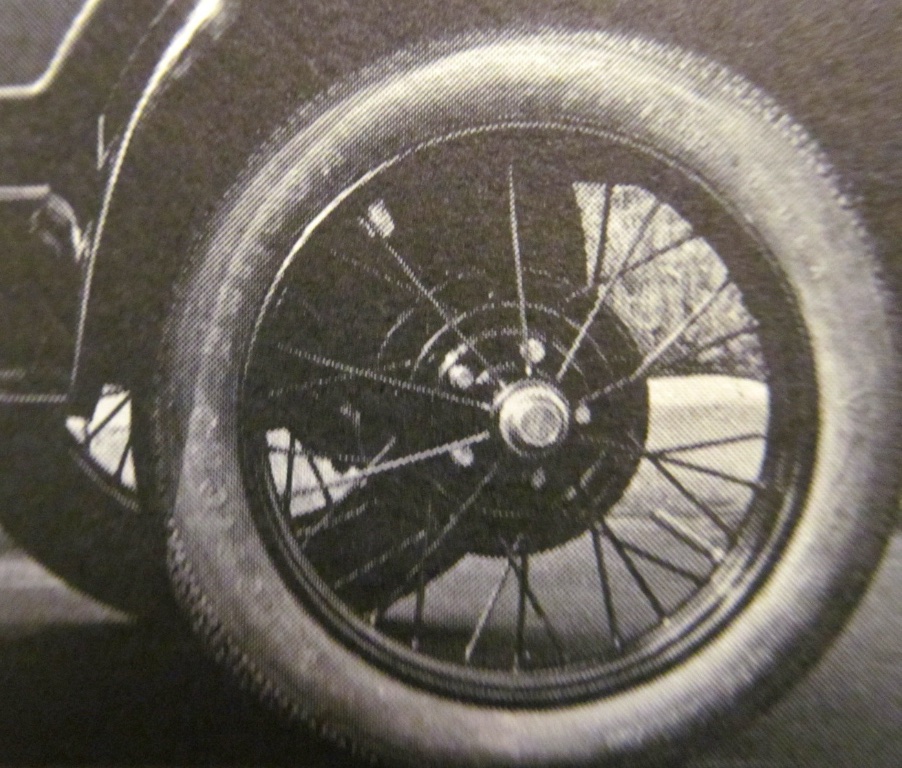

Just to add a bit on the dust caps. The wire wheel used 3" long dust cap, as the standard valve stem stuck up higher since no thick felloe , like the wood wheel has.
Note height of the dust cap

Re: Metal Tire Stem Article?
Larry, the two valve sizes ended in October 1920 when the Ford obsoleted the larger size valve stem. That one was 3-3/8" long x 15/32" diameter (just shy of 1/2"). The remaining valve stem was exactly 3" long x 13/32". Just FYI.
