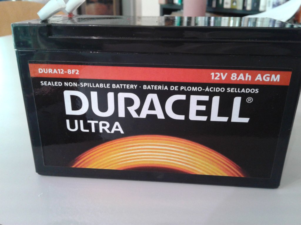

I use a small 12 volt battery to Buzz my coils:
What gauge wire should I use between the battery and the coil box on a 1915 non starter car?
