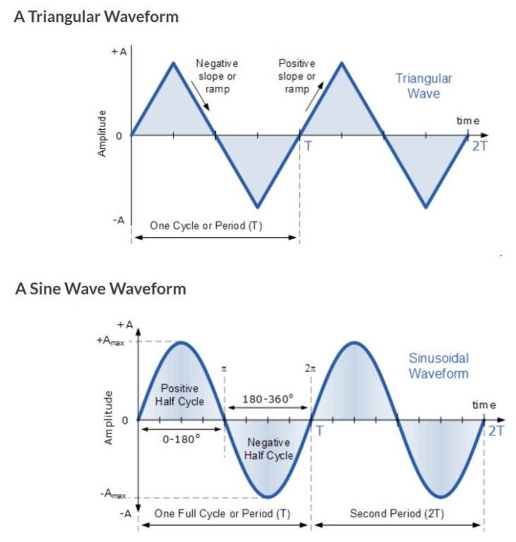

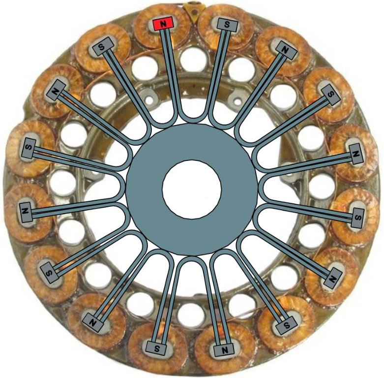

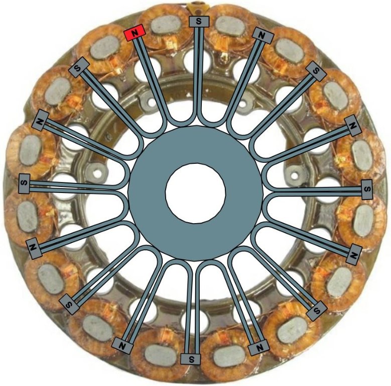

No, the unloaded Model T Magneto output voltage more closely resembles a Triangular waveform with respect to time not a Sinusoidal waveform.The output is a sign-wave of alternating voltage.
The Magneto output waveform is determined by the geometry of the fixed coils with respect to rotating rectangular pole pieces. The voltage output is minimum (0V) when the rotating pole pieces are centered over coil centers; Where the magnetic lines of flux are concentrated at the iron core and none cut the coil coil windings.
The Magneto output voltage is Maximum when the rotating pole pieces are evenly positioned between adjoining coils; Where the maximum magnetic lines of flux cut the maximum number of coil turns
The voltage polarity reverses as the pole piece magnetic polarity changes. The Magneto output voltage frequency is directly proportional to the flywheel rotational frequency with a factor of 8 (1 flywheel rotation produces 8 complete positive/negative cycles of Magneto voltage output; 8 positive and 8 negative). 16 voltage pulses per flywheel revolution in total.
